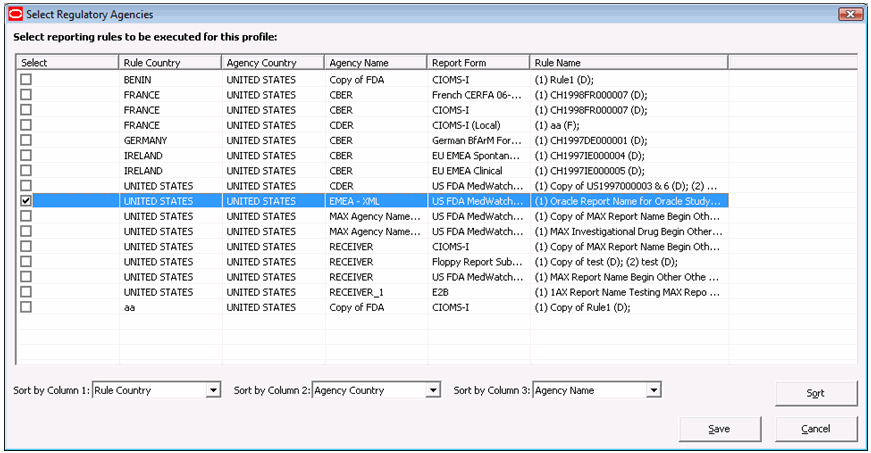

If you select Select Regulatory Agencies in the Schedule Expedited Reports field when you are configuring a study definition, Oracle Argus Unblinding also displays the Select Regulatory Agencies dialog box. This dialog displays all the Reporting Rules in the Oracle Argus Safety Application, grouped by Rule Country, Agency Country, Agency and the Report Form Name. The column headers can be stretched to make the column wider to display more data. The following lists and describes the fields and controls in this dialog box.
The following table describes Select Regulatory Agency Dialog Box Fields and Controls:
| Field/Control | Description |
Select |
Enables you to select the reporting rules this profile is to execute. |
Save |
Saves the reporting rules and closes the dialog box. |
Cancel |
Closes the dialog box without saving data. |
Sort |
Sorts the data according to the options selected in the Sort by Column 1, Sort by Column 2, and Sort by Column 3. |

- If you chose Select Regulatory Agencies in the Schedule Expedited Reports field in the preceding step, the system displays the Select Regulatory Agencies dialog box.
- Click in the appropriate checkboxes to select one or more Agency/Rule.
- Click Save.
