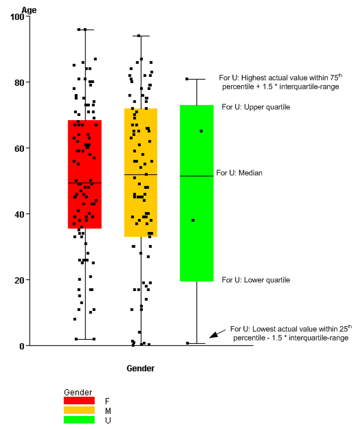

For example, a report shows age and gender for each case ID:
Depending on the display options that you specify, the graph might look like this:
