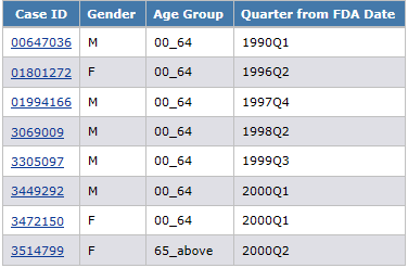

For example, a report shows gender, age group, and quarter from FDA date for each case ID:

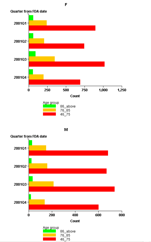

Depending on the display options that you specify, the graph might look like this, where Gender is the subset variable, Quarter from FDA date is the primary variable, and Age Group is the secondary variable:
