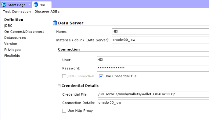

Launch the ODI studio and create a connection to the ODI repository, for example, OHF_ODI_REPO. |
Connect to the Master Repository and update the work repository connection information from Topology > Repositories > Work Repositories > OHF_WORKREP Update schema password of OHF_ODI_REPO and Connection Details (ADW service name as either low, medium, or high). |
Connect to the Work Repository (OHF_WORKREP) and update the OHF Schema connection information from Topology > Technologies > Update Schema password and Connection Details (ADW service name as either low, medium, or high) for the Schemas shown.

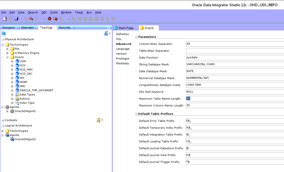

Update the Max Table and Column length to 35 in ODI Studio > Topology > Oracle. Maximum Table Name Length = 35 Maximum Column Name Length = 35
