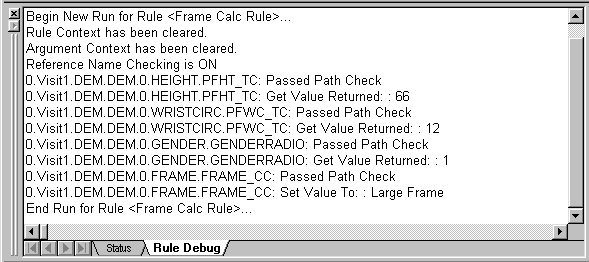

The following script illustrates a calculation that requires input of three values for which the RefName path is specified in the script. When you run the rule with the RefName checker on, the output shows that the rule debugger has checked each RefName path. Additionally, because this is a calculation rule, the rule debugger displays the result of the calculation.
