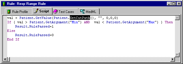

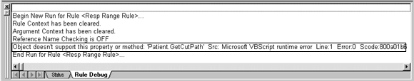

The following script has a typographical error in the first line. It should reference the GetCurPath method of the Patient object. The rule debugger reports this mistake as a syntax error.
