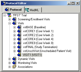

  1. Select Trial > Protocol Editor to open the Protocol Editor window.
  2. To add the first visit of the trial, click the trial name with the right mouse button and select Add Visit from the pop-up menu.
    To add a subsequent visit, click the visit that you want the new visit to follow and repeat the process.
    Alternatively, drag the visit icon from the Object Palette toolbar and drop it in the location you want.
    The hierarchical representation of the trial is updated to show the new visit, and the Properties window displays a set of default properties.
