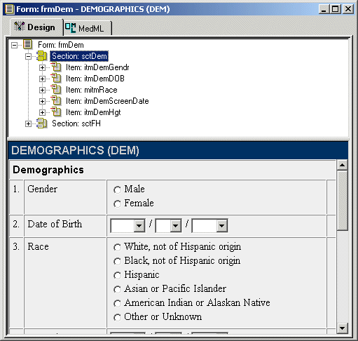

The Design tab of a Form editor window enables you to see the structure of a form and its components and to see a preview of the way a form will look in the InForm application. This tab has two panes:
- The top pane consists of a hierarchical representation of the structure of a form and its components. Each type of form component is represented by an icon and a tree control that you can expand or contract.

- The bottom pane consists of a preview of the form as it will appear online in the InForm application.
