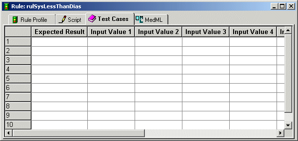

Test Cases tab
The Test Cases tab enables you to define test data for a rule so that you can run the rule script in test mode. In defining a test case, you specify the expected result and a value for each item that the rule checks. When you define a test case, the InForm Architect application adds it to the MedML definition of the rule. When you run a rule in test mode, the InForm Architect application substitutes the test data values for selected test cases or for each test case in succession and displays the test results in the Output window.
