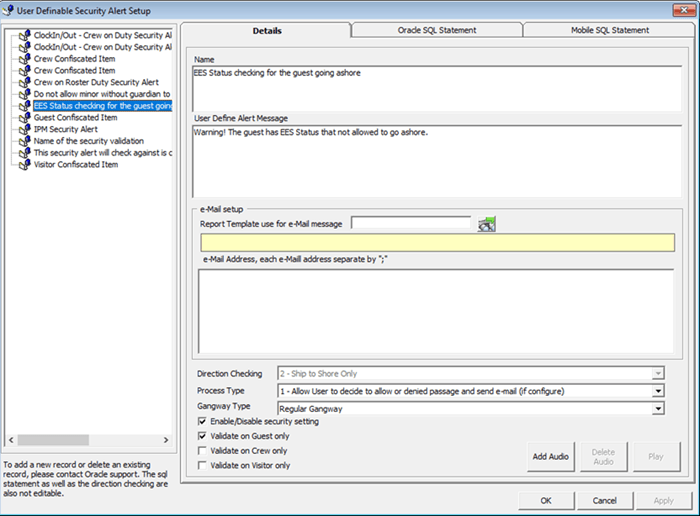

New User Definable Security Alert Setup
In the Administration, Security Setup, User Definable Security Alert Setup, you will find the EES Status checking for the guest going ashore, allowing you to configure an alert for use in the Gangway Security module.
Once setup, the security alert will check the arrival guest’s harbor country for the following European countries:

Figure 7-1 User Definable Security Alert Setup
This figure shows User Definable Security Alert Setup field in OHC Administration
