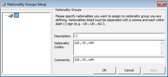

Setting Up Nationality Groups
Figure 9-1 Nationality Groups Setup
This figure shows Nationality Groups Setup window
  1. From the System Codes menu, select the Nationality Groups.
  2. In the Nationality Setup window, right-click the blank space at the left panel and select Add Nationality Group.
  3. Enter the description, the Nationality Codes with a hyphen (-) before and after the code and a comma (,) to separate the codes.
  4. Enter a Comment, if any.
  5. Click Apply to save.

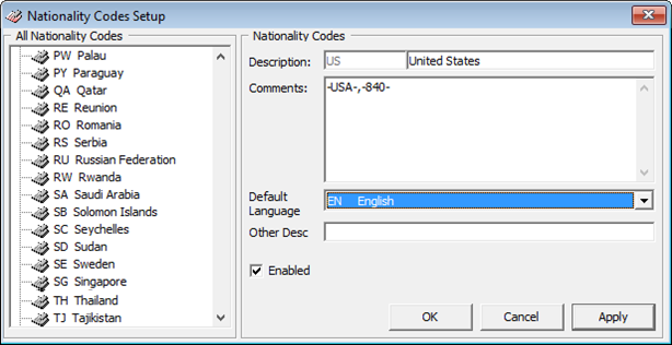

Setting Up Nationality Codes
Figure 9-2 Nationality Codes Setup
This figure shows Nationality Codes Setup window
A set of standard ISO nationality code is pre-installed in the system. The steps to configure the Nationality Codes is same as the above. You can define the language use for each nationality code by changing the default language.
