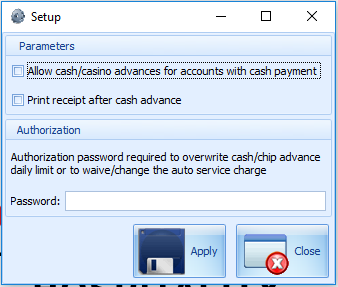

1 - Allow postings for accounts that only have Cash registered as payment type. 0 - Do not allow postings on these accounts This is to ensure that only passenger accounts that has a credit card registered on their account are allowed to charge the Casino postings to their onboard account. Parameter is accessible through OHC Casino, Setup, Parameters. |

Overwrite Limit Password |
<value> |
Password to overwrite daily limit for cash/chip advance postings. Directly Set Password through OHC Casino instead of Administration module as the password will be encrypted. |
Print Receipt |
<value> |
1 - Print receipt after cash/chip advance posting / 0 - Do not print receipt Accessible through OHC Casino, Setup, Parameters. |
