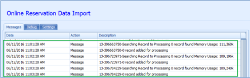

Refresh Interval
Below figure shows the system constantly checks for new records to process every 60 seconds intervals or per interval time defined.
Figure 5-1 Sample Refresh Interval Messages

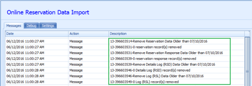

Delete reservation data older than 60 Days
In the Messages tab, data older than 60 days from date of modification is removed.
Figure 5-2 Sample Deleted Reservation Message

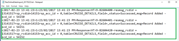

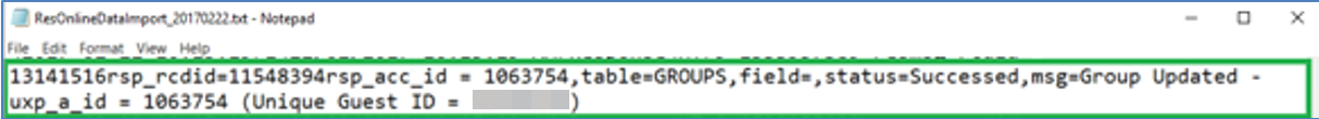

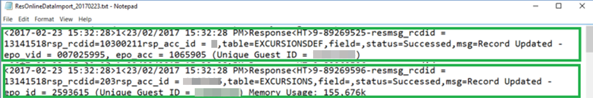

Log SQL statement
The system logs an SQL
statement into a log file in C:\Users\Public\Documents\Oracle
Hospitality Cruise\ResOnlineDataImportYYYYMMDD.txt if you
have the Log SQL Statement checked in Parameter1. You can view the
statement from the Debug tab.

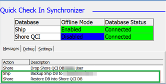

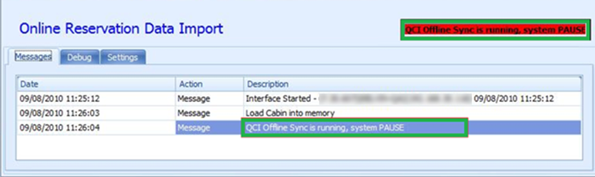

Stop process when QCI Offline Sync is enabled
This parameter backup and restore the latest database to QCI Shore Database when the parameter is enabled and QCI Sync Interface is started.
At the point when Quick Check In Synchronizer Ship database mode is in a Enabled status in Offline Mode, the DGS ResOnline Interface status switches to a PAUSE and resumes when the Offline Mode is Disabled.
Figure 5-4 QCI Synchronization Status
Figure 5-5 DGS Pause Mode

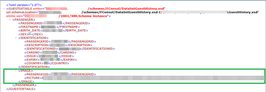

Guest Picture Import
The application supports
importing of guest picture from an XML file and insert the value into MSSG_GUEST_HISTORY field, and stores the picture in SEC table. The picture cannot be updated after the Guest
checks-in.
Figure 5-18 Sample picture string in XML file format
