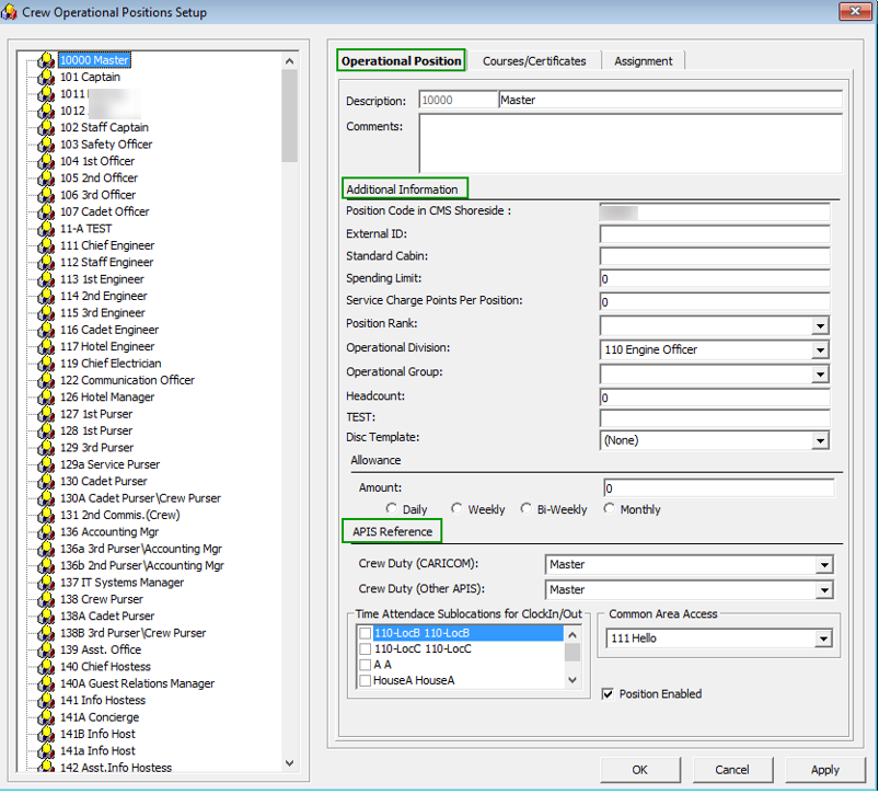

Figure 2-1 Crew Operational Position Setup
Login to Administration module and select Crew Setup, Operational Position from the drop-down list.
Right-click and select Add to create a new Operational Position or select from the existing list.
Navigate to the Operational Position tab and enter the Position code, description and comment.
Under the Additional Information section, select the Operational Division from the drop-down list.
Under the APIS Reference section,
Define the Crew Duty (CARICOM) position
Define the Crew Duty (Other APIS) position
Click OK to save.

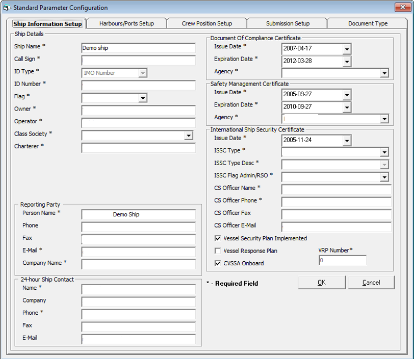

Ship Information Setup
To generate a report, you must first setup the Ship information in the EBorder UK application.
Figure 2-3 Standard Parameter Configuration Window
Run the EBORDER UK.exe.
Select EBORDER UK Setup from the EBORDER UK Transfer.
At the Ship Information Setup tab, enter the ship’s information.
Click OK to save.

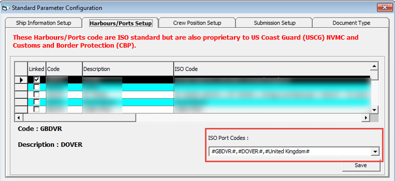

Port Setup
The Port Setup is differentiated by the symbols used and stored in the XML files. For example, the ISO Port Code for Dover has “#” and “<”. This means the ISO Port is shown in the Standard Parameter Configuration, Harbours/Ports Setup, ISO Port Codes and eNOAD Port. See below table and figures for symbol use in the port setup.
Figure 2-4 Harbours/Ports Setup
Table 2-2 APIS Port Type and Symbols
| Port Type | Symbol |
CARICOM Port |
eNOAD Port |
Panama Canal ADR Port |
eBorder UK Port |
