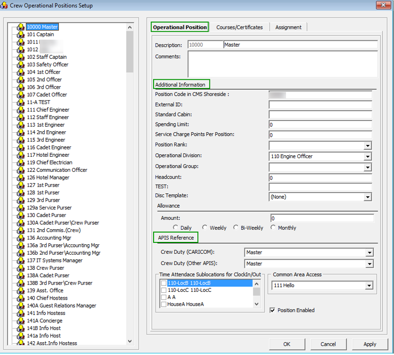

Operational Position Setup
An Operational Position is required in the Advanced Passenger Information System (APIS) for references and reporting, and this is set up in Administration module.
Figure 2-1 Crew Operational Position Setup
This figure shows the Crew Operational Position Setup.
  1. Login to Administration module and select Crew Setup, Operational Position from the drop-down list.
  2. Right-click and select Add to create a new Operational Position or select from the existing list.
  3. Navigate to the Operational Position tab and enter the Position code, description and comment.
  4. Under the Additional Information section, select the Operational Division from the drop-down list.
  5. Under the APIS Reference section,
    1. Define the Crew Duty (CARICOM) position
    2. Define the Crew Duty (Other APIS) position
  6. Click OK to save.

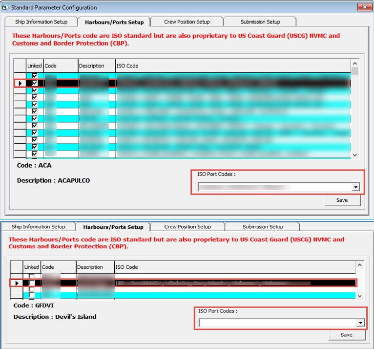

Port Setup
The Port Setup is differentiated by the symbols used and stored in the XML files. For example, the ISO Port Code for Acapulco has “<” and “-”. This means the ISO Port shown in the ENOAD module, ISO Port Codes whereas the port for Devil’s Island is excluded from ENOAD. See below table and figures for symbol use in the port setup.
Figure 2-4 Harbours/Ports Setup
This figure shows the Harbour/Ports Setup window and the ISO Port Codes with corresponding symbols used.

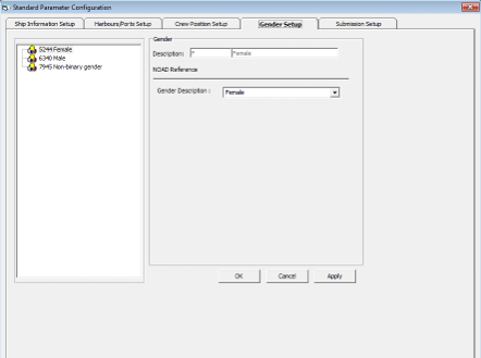

Gender Setup
The gender setup is required in the ENOAD gender references.
  1. Log in to the Administration module, select Gender Setup, select the Gender from the left panel and in the Gender Description, select a gender from the drop-down list.
  2. Click OK to save.
    Figure 2-5 Gender Setup
    This figure shows the Gender Setup
