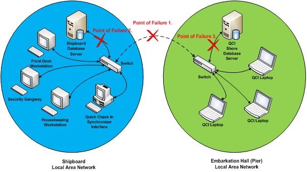

Figure 9-1 QCI Sync Failure Points
Failure 1
Network connection lost between the shipboard database and the shore-side QCI database.
The database synchronization between the ship and the QCI Shore database has stopped.
Check and ensure the Oracle Database Listener has started and user ‘UID’ and password exist in the database schema.
This does not affect the ship operations and the shore embarkation operation. All the reservation changes made on both databases are logged to CHG table for synchronization at a later stage.
The interface tries to reconnect to the shore QCI database every number of seconds, depending on the time interval setup on the interface and synchronization resume after the network connection is restored.
Failure 2
The Ship database server network cable disconnected or database service has stopped.
This does not affect the shore embarkation operation and all the reservation changes are logged to CHG table to be synchronized later. The shipboard operation is affected due to the lost connection from the shipboard database server.
The error message popup on QCI Synchronizer Interface is
"ORA-03114: not connected to ORACLE"
. The error message popup on ship workstation is"ORA-03113: end-of-file on communication channel"
Failure 3
QCI Shore database server network cable is disconnected or database service has stopped.
The synchronization between the ship and the QCI Shore database has stopped. The shipboard operation is not affected and all the reservation changes are logged in the CHG table for synchronization at a later.
This affects the shore embarkation operation due to the lost connection from the QCI Shore database server.
The error message popup on QCI workstation is
