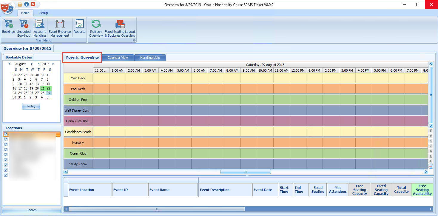

Figure 2-1 Event Overview
This figure shows an overview of event by venue in Event Overview tab.
This window is divided into two sections providing you:
  • A view of all bookable events according to the event start and end time.
  • List all events of the selected date, including information such as start and end time, seating type minimum / maximum attendees, total bookings and others.

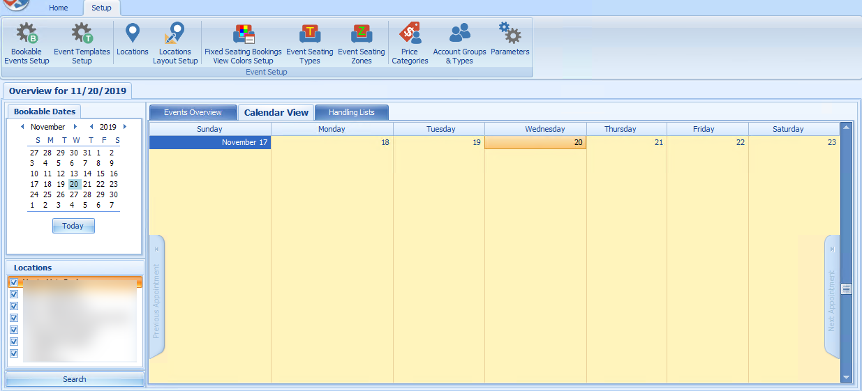

Figure 2-2 Calendar View
This figure shows the event in Calendar View.
The Calendar View displays the weekly event of the selected date in time order. Scrolling downwards will move the date forward by week.

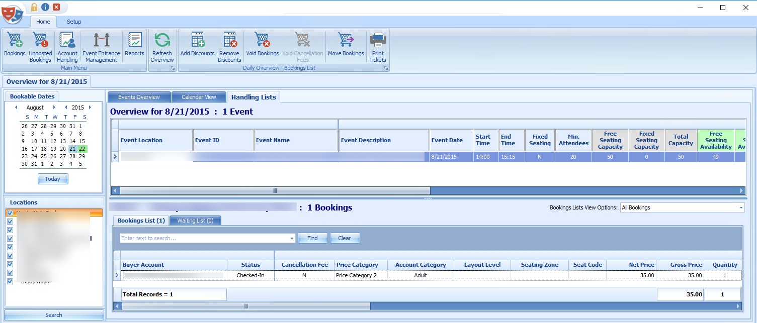

Figure 2-3 Event Handling List
This figure shows the Event Handling Lists tab where bookings and waiting lists are listed.
The Handling Lists provide an overview of the selected event allowing you to manage the event from one location. It lists the details and total number of events of the selected date in the grid. List of the bookings are shown in the Booking List tab while the Waiting List tab lists all the guest on waiting list. The total number of bookings for the event is shown in the far right of the grid. Scroll right to view the remaining columns.

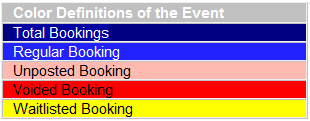

Figure 2-4 Color Definition
This figure shows the color definition for each booking type.
Booking List
Under the Booking List tab, you can perform functions such as Add Discounts, Void, Move Bookings, and Print Tickets. See chapter Account Handling for more details.

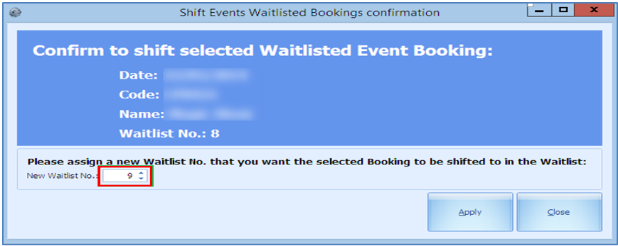

This function enables you to reorder the waitlist booking, depending on the new number you insert. For example, if the current waitlist number is eight and the new waitlist number is ten, it will move this booking to the bottom of the list.
  1. Select the booking to shift from the Waiting List tab.
  2. Click the Shift Waitlisted Bookings button at the ribbon bar.
  3. Insert a new waitlist number and click Apply.
Figure 2-5 Shift Events for Waitlisted Bookings
This figure shows the Shift Event Waitlisted Bookings window option that allow you to reorder the waitlist list.

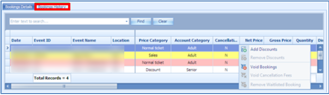

The Booking details tab displays details of the selected event, total records and prices. Functions such as Add Discounts, Remove Discounts, Void Bookings, Void Cancellation Fees, and Move Bookings can be performed by right clicking the selected booking or use the button at the ribbon bar.
Booking History
Figure 2-8 Booking History
This figure shows the Booking History tab in Booking List.
This tab displays the history details of event previously booked. Scroll to the right for more information.

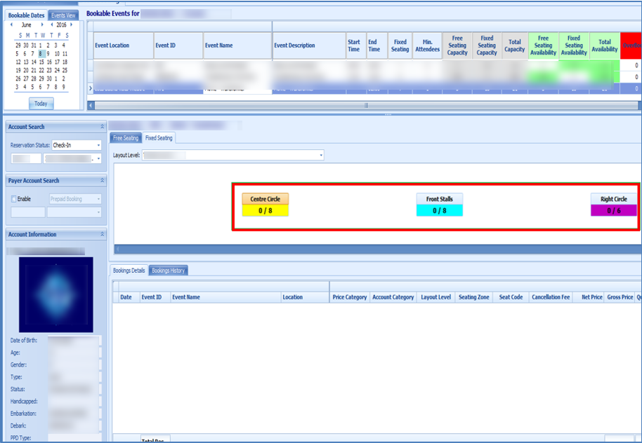

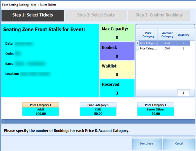

  1. To book a Fixed Seating event, choose a event from the Event Bookings tab. Select a guest and select a fixed seating event.
  2. Under the Fixed Seating tab, select a layout from the drop-down list. The available pricing for the selected layout is displayed, For example ‘0/8’ in the xxx Price Category. “0” indicates number of tickets booked, “8” indicates the total number of tickets available.
  3. At the Booking Wizard Step 1: Select Tickets,
    1. Select a Price Category and the number of tickets.
    2. Click Select Seats to go to Step 2:Select Seats allocate a seat number. The default layout view for this booking is Booking View. You can change the view to Zones or Type.
    3. Click Book Seats.

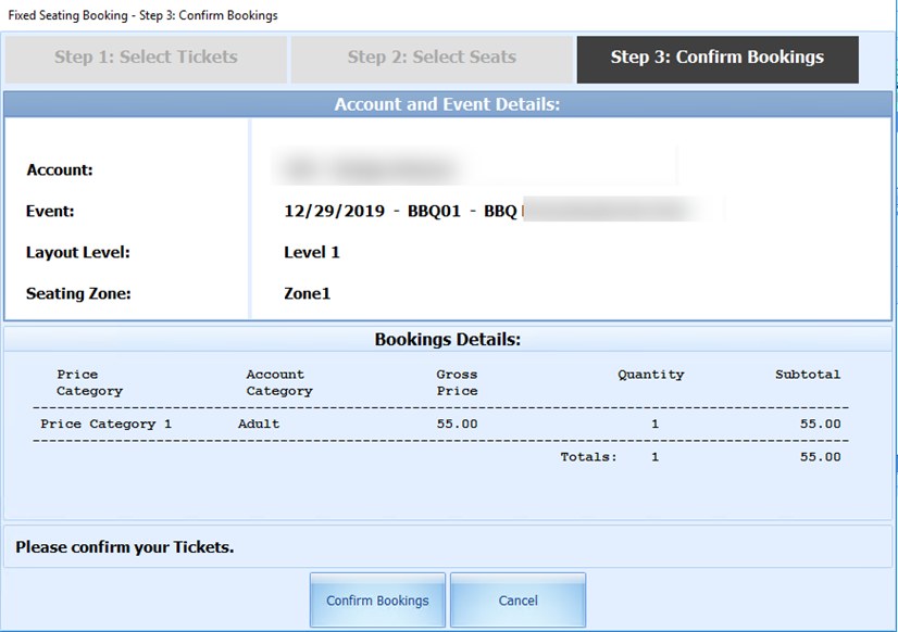

    4. At the Step 3: Confirm Booking tab, verify the information shown and click Confirm Bookings to complete the booking.
    Figure 2-9 Fixed Seating Booking Step 1: Select Tickets

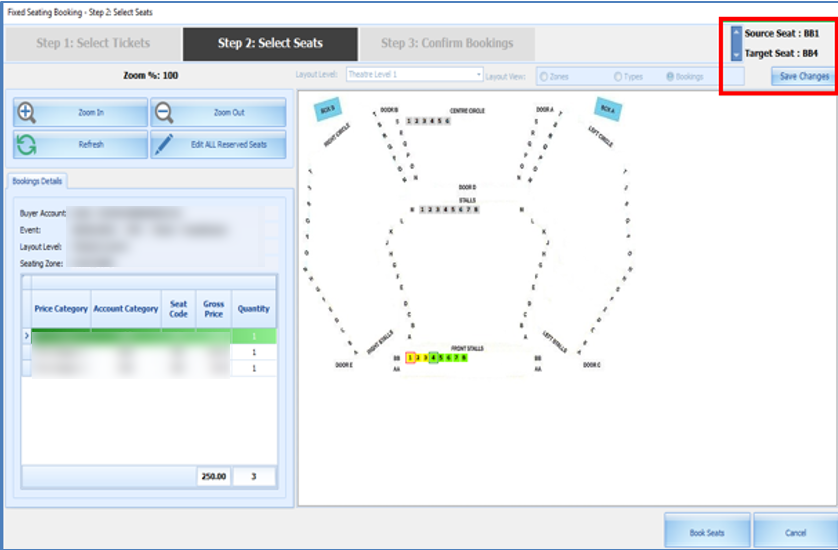

Relocating Seat in Step 2 of Booking Wizard
Figure 2-10 Fixed Seating Booking Step 2: Select Seats
This figure shows the Fixed Seating Booking — Step2: Select Seats.
To move an allocated seat to another in Step 2:Select Seats,
  1. Select Edit ALL Reserved Seats. This button toggle to Stop Editing ALL Reserved Seats and vice versa when clicked.
  2. Select a new seat code to begin from the layout.
  3. For example, the assign seat is BB1-BB3 and selecting BB4, this will move all three seats to BB4-BB6.
  4. If the number of the allocated seats are less than the seats you are moving, a message shall prompt.
  5. Click the Stop Editing ALL Reserved Seats once all seats are moved.
  6. Click the Save Changes to update the layout view and at the grid.
  7. Once confirmed, click Book Seats to go to next tab, Step 3: Confirm Bookings.
  8. Complete the booking by clicking the Confirm Bookings.
Figure 2-11 Fixed Seating Booking Step 3: Confirm Booking
This figure shows the Fixed Seating Booking — Step3: Confirm Bookings.
