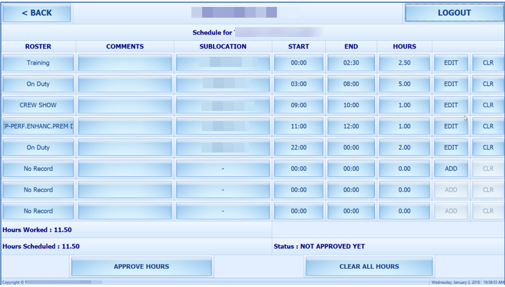

Press the Approve worked hours to show the previous day schedule.
To add or edit the existing time slot, press the ADD or Edit button.
At the Time Slot screen, select a Roster State, the Start/End time and Sub-location. When selecting the time, use the left or right arrow button to decrease/increase the hours, and each slot is in 15 minutes block. You can use the arrow up/down keys on the keyboard to increment or decrement the minutes in block. Pressing any other keys will increment the time by a 15 minutes block.
Figure 6-2 Add Time Slot Window
Press OK to save and return to the previous screen.

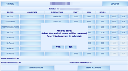

Pressing the Clear all Hours resets the daily roster.
When adding/editing the time slot through T&A Terminal:-
Overlapping of start/end time is not permitted
The system does not perform an ILO Compliance validation
Figure 6-3 Schedule Work Hours Window
At the Schedule Work Hours screen, press the Approve Hours to confirm or approve the worked hours.
Crew can modify the schedule prior to manager’s approval or log in before the specified work time approval. A schedule that is approved by crew can be modified by the manager at any time and not vice versa. Both the Approve Hours and Clear All Hours are dimmed after the schedule is approved by a manager.

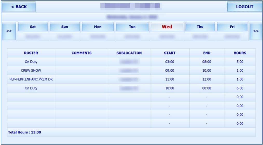

View My Schedule
Figure 6-5 View My Schedule Window
Pressing the day displays the respective daily schedule.
Pressing the double left arrow shows the past two week’s schedule and double right arrow to view the next two week’s schedule.

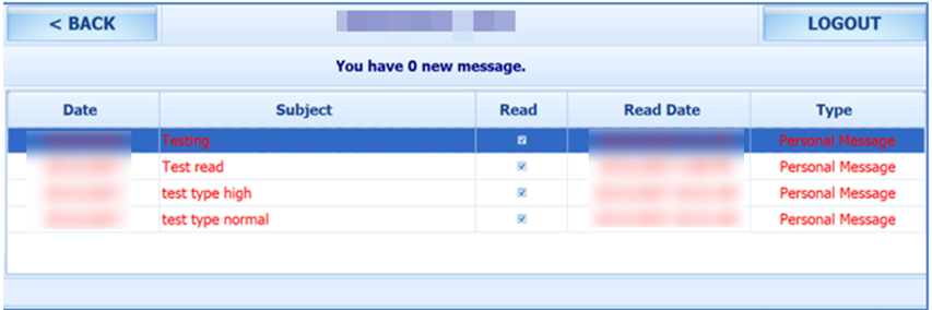

View My Messages
The View My Messages displays all the crew’s messages, sorted by date in descending order. The number of days to display is set in the parameter “Time Attendance”, “Display Messages x days old at terminal”.
If the value is set to 14 days, all read/unread messages that are 14 days old is shown.
Figure 6-6 View My Message Window
To view the message details, select the message from the message list
To delete the message, press the Delete button from the message dialog box
To exit the Detail Message screen, press the Close button. Read messages are shown on the message grid and viewable unless they are outside the number of days defined

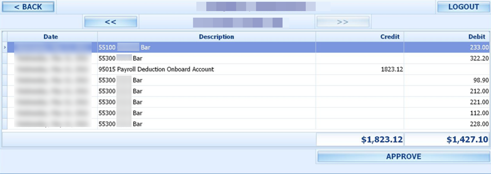

View My Account
View My Account enables you to view the previous or current cruise posting, and the default display is the current cruise posting.
Approve Onboard Charges
It is compulsory for crew that opt to settle their invoices through payroll deduction set in Payroll module, Crew, Edit Details, Contract Type/Pay Group/Pay Position tab to approve any onboard charges.
Payroll companies has “Deduct Folio” and “Invoice Payment Receiving” enabled
Settlement department setup is similar to Payroll Companies – Onboard Account Department
Crew payroll contract has “Deduct Folio” enabled
The system sends a message informing the crew of the onboard charges that requires an approval and enables the Approve button in the View My Account screen.
Figure 6-7 Approve Onboard Charges Window
From the View My Account screen, select a transaction to approve. Multiple selection is not allowed.
Press the Approve button. Once approved, the Approve button will change to Already Approved.
If there are new settlements in the crew invoice, another approval is required.

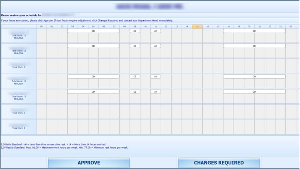

Approve My Weekly Hours
Approve My Weekly Hours enables you to approve the roster on weekly basis and the function require the following parameter: “Time Attendance”, “Approve Weekly Hours” set to 1 and “Time Attendance”, “Approval Frequency” is set to the same day as the server day. The Approve My Weekly Hours screen pops up whenever you log in to the terminal, if there are unapproved weekly hours.
Figure 6-8 Approve My Weekly Hours
Total Work: The total hours worked
Total Rest: The total rest hour block 1
MNA: Schedule not yet approved by Manager
CNA: Schedule not yet approve by Crew
CHG: Changes in schedules
When the Approve My Weekly Hours is pressed, the system always shows the last week’s schedule.
Approve: Approves the week’s schedules
Changes Required: Trigger a change request notification to the Department Head for the week schedule to be changed

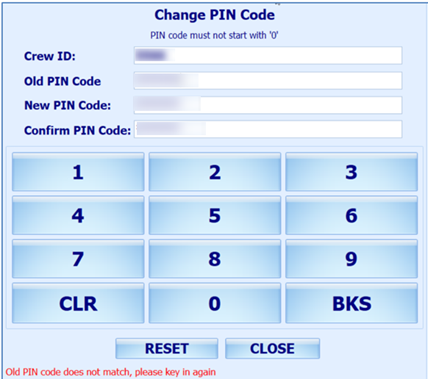

Changing PIN Code
The Change Pin Code function changes your log in PIN for the T&A Terminal access.
Figure 6-9 Change PIN Code
Press the Change PIN from the menu option.
Enter the required information. Use the following keys to navigate.
CLR: Clears the field input value
BKS: For backspace
RESET: Changes the PIN code
CLOSE: Cancels the PIN code change
The system prompts a PIN code change successful or a warning if,
The PIN code length does not match the value set in parameter “General”, “PIN Code Length”.
Old PIN code entered is incorrect.
Missing information on the required fields.

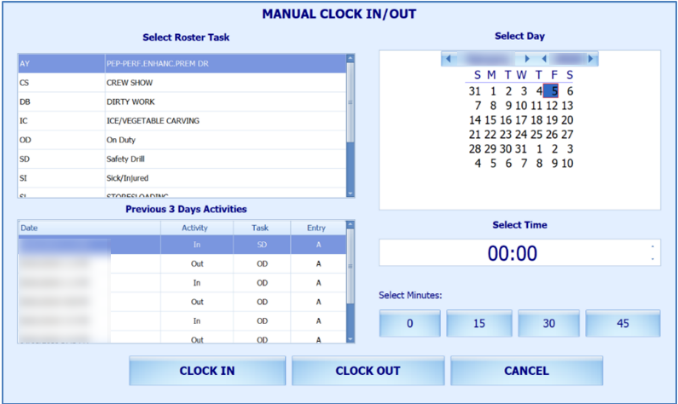

Manual Clock-In/Out
Manual Clock In/Out allows you to manually clock in/out from the system.
At the Main Menu option, press the Manual Clock In/Out.
Select the Roster task, day and time.
Press Clock In or Clock Out to manually add the record. The past three days activities will be shown on screen.
Figure 6-11 Manual Clock-In/Out
