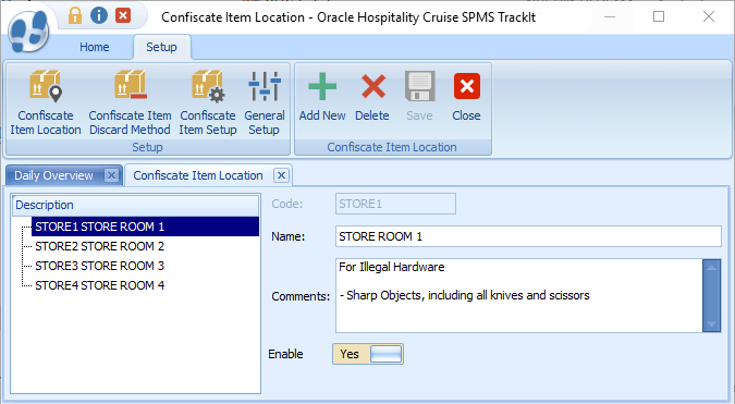

Confiscate Item Location and Item Discard Method
Figure 1-1 Confiscate Item Location
From the Setup tab, click Confiscate Item Location or Confiscate Discard Method Item.
To create a new record, click Add New.
Enter the short code, description and additional comments. For example, Stores Sharp Objects or Items Hand over to Customs.
The newly added code is “Enabled” by default. To disable the record, slide the menu to the left to switch the display to No.
To save the code, click Save.
To enter an additional item, repeat from Step 1.

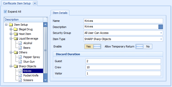

Setting Up the Confiscate Item
A Confiscate Item is a list of items prohibited or restricted on-board of the ship. these items are categorized into categories, depending on the nature of the items.
Figure 1-2 Confiscate Item Setup
Creating a Confiscate Item Category
From the Setup tab, click the Confiscate Item Setup.
To create a new category, select Item Setup and click Add New.
Enter the Item Code, Name, and Description
To save the new category, click Save.
Select an Item Category from the tree view and click Add.
Enter the Item Name, Description.
Select the Security Group from the drop-down list. The Security Group is defaulted to “All User Can Access” and this is set up for the User Security module. See topic Appendix A. User Security Group for more information.
The Item Type is default to the selection from the tree view and is enabled by default.
By default, the Allow Temporarily Return is set to No. If the item allows for temporarily return, slide the button to the right to set it to Yes.
At Discard Duration section, define the maximum number of days to keep the item in the store. The default value is 0 – never discard.
To save the record, click Save.
To enter additional Confiscate Item, repeat steps 2 to 7.

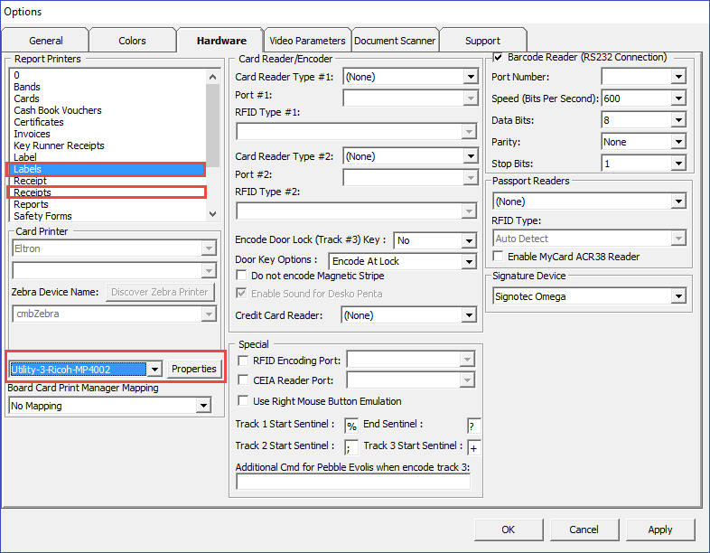

Login to Management module and select Options from the menu.
Navigate to Hardware tab, Report Printers section.
Ensure Labels and Receipts type is assigned to a printer.
Figure 1-4 Management Module Printer Configuration

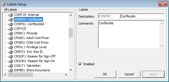

Setting up System Labels
Login to Administration module, select Administration, System Setup, Labels Setup.
Locate the label codes CONF00 and CONF01.
Figure 1-5 Label Setup
Select the code and enter a new label description, and click OK to save. The label code “CONF00” refers to the word “Confiscate” and is displayed on the following windows:
Setup menu ribbon bar
General Setup: ‘Prompt Signature Capture when...’
Confiscate Item Discard Method
Ability to show for ‘Button ‘Confiscate Item’ in menu Confiscate Item
Overview window: Total Item Confiscated Today
Overview window: Top 10 most confiscated item
Confiscate Item: Confiscated Item
Management module: Loyalty/Track It tab, Confiscated Item section
