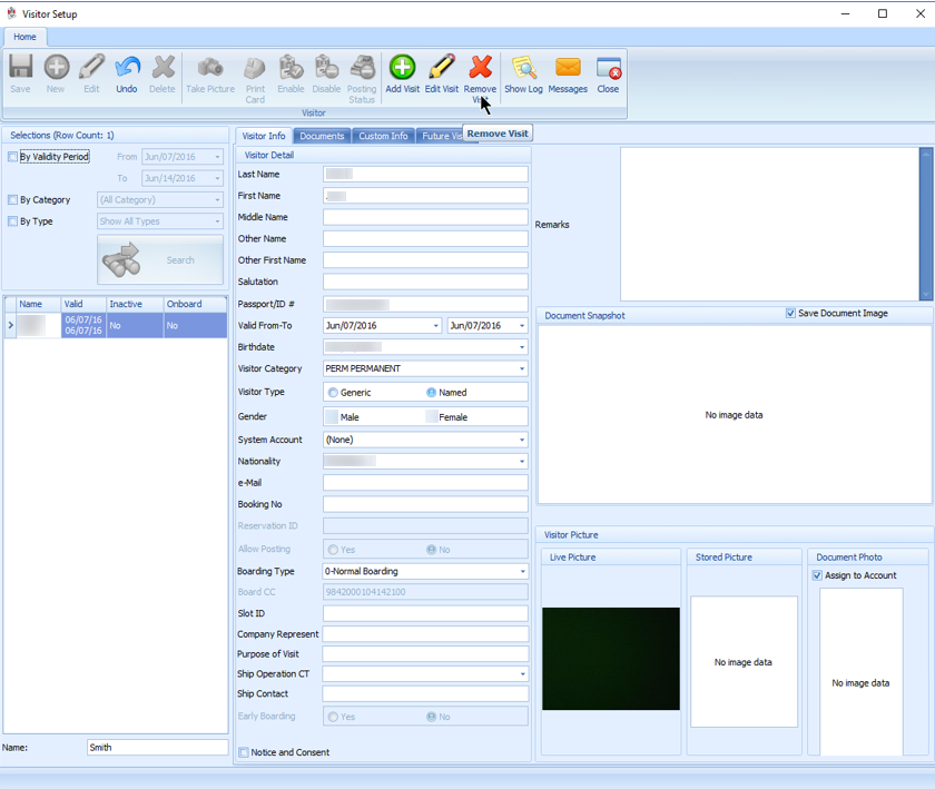

Figure 7-1 Visitor Registration Form
At the WPF Security main window, click the Visitor icon on the Toolbar to open the Visitor Setup form.
At Visitor Setup form, click New to add a new visitor record and fill in the details in the Info tab.
At the ribbon bar, click Take Picture to capture a live picture. Ensure a camera is attached to the workstation and the device is correctly setup in Management, Option, Video Parameter.
Click Swipe Passport at the ribbon bar to open the ATB Document Entry form, then scan the passport through the passport reader and then click OK to save.
Click the Print Card to generate a visitor board card. This function starts the Batch Board Card Printing if the card failed to print.
Select the Notice and Consent checkbox located next to the Name Search field. If this checkbox is deselected, the system prompts a warning message and disallow you to proceed.
Click Save to save the visitor record.

Adding Future Visits
Future visits can be added to visitors who visit the ship regularly.
At the Visitor Setup window, search the visitor record using the filters or enter the last name in the name search field.
Click Edit at the ribbon bar.
Navigate to the Future Visits tab and at the ribbon bar, click Add Visit.
Select the visit date from the calendar and click OK to add.
To edit, click the Edit Visit and select a new date.
To remove, select the visit date from the grid and then click Remove Visit.
