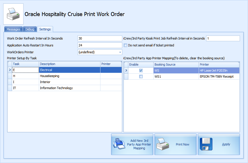

Figure 1-1 Print Manager Settings for Work Order
Configuring Printer for Work Orders
- Log in to the Administration module and select System Setup, Database Parameters.
- At the Maintenance Parameter group, set the value to 1 at
- Use Work Order Printer Service
- Print by Task - if you wish to print the work order by task
- Click OK to save and exit the application.
- Launch the Print Manager application and navigate to the Settings tab
- Set the Interval Seconds and Auto Restart In Hours for the module.
- At the Task Type, choose the printer from the list for each task type.
- Click Apply to save.
Configuring Printer for Third-Party Application
Login to Print Manager program.
At the Settings tab, set the print job refresh interval seconds
To disable the email notification once a ticket is printed, check mark ‘Do not send email if ticket printed’
Click the Add New 3rd Party App Printer Mapping button to enable a printer
Choose a printer for each type of booking source from the drop-down list
Click Apply to save
Restart the interface
If the printer is set up successfully, the action task is displayed in the Messages tab.
Figure 1-2 Print Manager - Messages Tab
[#Work Order Print Service.PARAM.Restart Interval=24#]
[#Work Order Print Service.PARAM.Refresh Interval=30#]
[#Work Order Print Service.PARAM.Kiosk Refresh Interval=5#]
[#Fidelio Cruise.Printer.WorkOrders=PrimoPDF#]
[#FCMaintenanceWork.PrintTask.CARP=#]
[#FCMaintenanceWork.PrintTask.COMM=#]
[#FCMaintenanceWork.PrintTask.DECK=#]
[#FCMaintenanceWork.PrintTask.ELEC=#]
[#FCMaintenanceWork.PrintTask.HOKE=#]
[#FCMaintenanceWork.PrintTask.HVAC=#]
[#FCMaintenanceWork.PrintTask.IT=#]
[#FCMaintenanceWork.PrintTask.LIGH=#]
[#FCMaintenanceWork.PrintTask.N/A=#]
[#FCMaintenanceWork.PrintTask.PLUM=#]
[#FCMaintenanceWork.PrintTask.SAF=#]
[#FCMaintenanceWork.PrintTask.SEC=#]
[#FCMaintenanceWork.PrintTask.TV=#]
[#FCMaintenanceWork.PrintTask.WOT01=#]
[#FCMaintenanceWork.PrintTask.WOT02=#]Configuring Printer for Board Card Printing

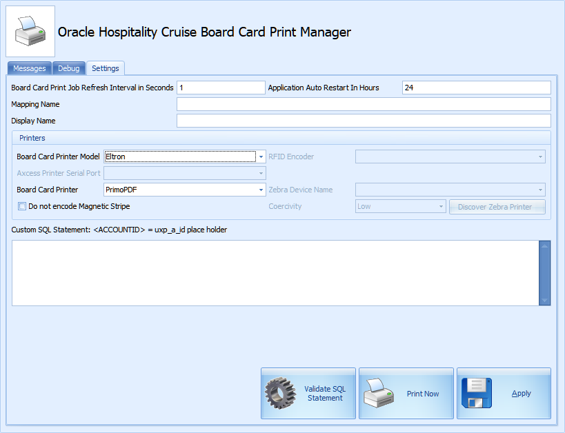

To print a board card, the OHC BoardCard Print Manager is used. This application works with Board Card printers only. It runs in the background and processes print job requests received during check-in.
In the Setting tab of the application, the default value HeartBeat Internal value is set at 60 seconds. You can change this to meet your operational needs.
Login to OHC Board Card Print Manager application.
At the Settings tab, enter the Mapping Name and Display Name for the printer.
Set the print job refresh interval seconds.
Select the Board Card Printer Model and Board Card Printer from the drop-down list.
In the SQL statement section, leave the setting blank to print all card types.
Restart the interface.
If the printer is set up successfully, the number of active task is displayed in the Messages tab.
Figure 1-3 Print Manager Settings for Board Card Printing
[#Board Card Print Service.PARAM.Restart Interval=24#]
[#Board Card Print Service.PARAM.Refresh Interval=1#]
[#Fidelio Cruise.Hardware.RFIDEncoder=#]
[#Fidelio Cruise.Printer.BoardCard=2#]
[#Fidelio Cruise.Printer.Cards=PrimoPDF#]
[#Fidelio Cruise.Hardware.Do not encode Magnetic Stripe=True#]
[#Fidelio Cruise.Hardware.Card Reader Port=-1#]
