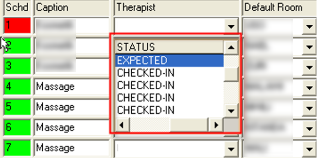

Therapists Schedule Information
In the same way as for Location Schedule, the appropriate Therapists are loaded from the Therapists Setup into the Therapists drop-down list boxes, allowing you to assign the appropriate Therapist to each schedule later.
Red: for Expected Therapists (and for schedules that are not link to any Therapists).
Green: for Checked-In Therapists.
Each displayed Therapist's tool tip text is showing the word Expected or Checked-In next to the existing Expected Disembarkation Date
Inside the Therapists drop-down selection box, you will find an additional column Status next to each Therapist’s name (Expected or Checked-In).
Figure 4-1 Expected Status

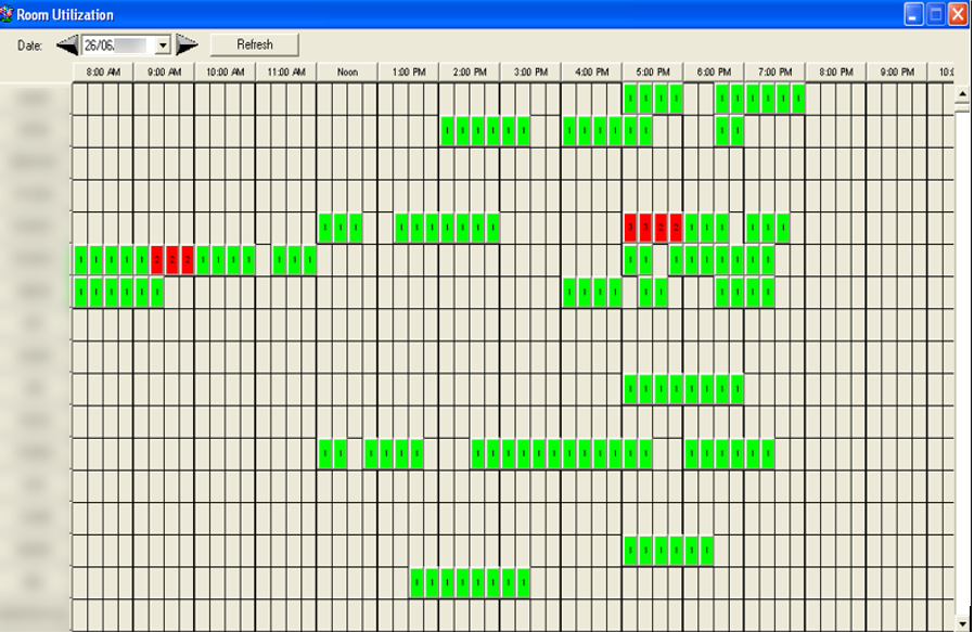

The Blocked Times are displayed with the default gray / dark gray / dark green & black colors.
All other Treatment (Expected & In House) Reservations are displayed in yellow.
Only Expected & In House Treatment Reservations are display here since this is a pure availability overview.Multiple Discount Periods

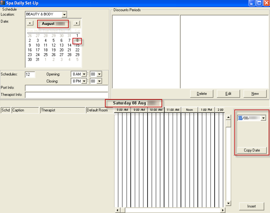

Setting up a Day
To set up a Day, choose the Location and Date from the calendar.
As soon as you click on the Calendar into a Date that does not exist as a Spa Location Daily Schedule, the system will load the default values for this Location as found in the Location Maintenance as well as in the Therapists Setup.
Number of Schedules
Opening and Closing times
The system will create the Therapists Schedules with their default captions, will load all appropriate Therapists into each Schedule’s Therapist drop-down list box and prepare them for further editing.
The system will also load all available Rooms into each Schedule’s Default Room drop-down list box.
Accepting the default Schedule caption or edit it.
Select the correct Therapist for each Schedule from the Therapist drop-down list box.
Select the default Room for each Schedule from the Default Room drop-down list box.
When done creating the schedule, click Insert to save it.
Copying a Previous Day
To avoid setting up each single working day, the system provides the functionality to setup a Day by copying the setup of an existing working Day.
Choose the Date you want to setup by selecting it from the calendar. The system will display an empty working Day as well as the option to select an existing Working Day and copy this Day’s Setup into the selected empty Setup.
Figure 4-2 Spa Daily Setup
Select the working Date you want to copy the setup from and then click Copy Date.
The copy process commence immediately and the date will have the same setup as the one yo copied from.
Additionally, the system will display two more buttons to either Update the proposed/copied setup or Remove Date to remove the proposed setup.
Clicking on Remove Date will result in removing the Daily Setup for selected Day “Are you sure you want to remove the Daily Setup for selected Date: 08/08/2019”

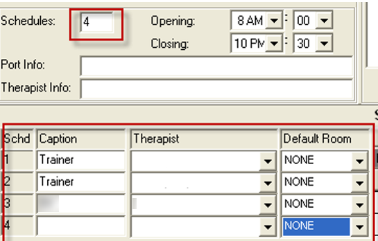

Adding & Removing Schedules
The function allow you to add additional schedules and therapist to the selected date.
Figure 4-3 Schedules
To do that, place the cursor to the Schedules text box and replace the number as shown in above figure from four (4) with six (6) and click Tab. The system will create to additional schedules where you can now enter their captions as well as select Therapists and default Rooms
After finishing all necessary changes, click Update to save. You can remove existing Schedules from a Daily Setup the same way, by reducing the Schedules number and clicking the Tab key. Clicking on Yes, will result in removing the last two (2) schedules and bring the total Schedules for this working Date to four (4) Schedules.
When you try to remove a Schedule that already has Appointments or Blocked Times assigned, the system will not allow it and will display the following warning message “There are already appointments for one of the schedules you are trying to delete. Cannot continue.”Assigning Crew Member to Schedules
When adding Schedules into the Daily Setup, the system by default leaves the Captions, Therapists and Default Rooms empty.
You can assign Therapists to those Schedules, by selecting the Therapist from the Therapist drop-down combo box and then click Update.
