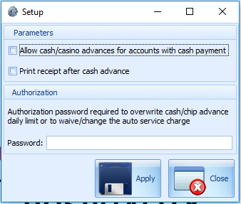

Accessing the Setup Page
You can access the Setup function from the Home of the Casino module.
Figure 1-1 Casino’s Setup Screen
This figure shows the Casino’s Setup Screen
At the Setup window, select the necessary checkbox to enable the parameters or enter the overriding password in the Password field and click Apply.
