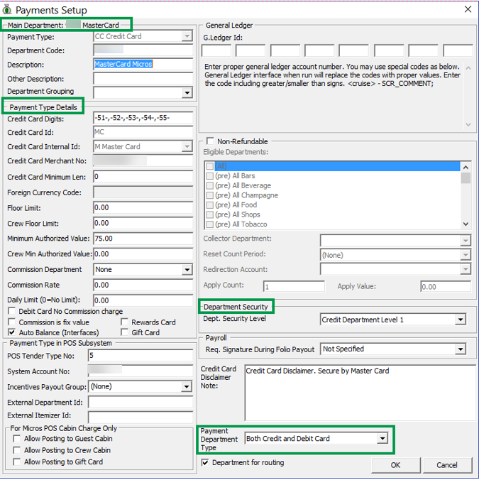

Department Setup
A debit/credit department code of a credit card type is required for charge/posting and this is setup up in Administration module, Financial Setup, Department setup.
Log in to Administration module and select Financial Setup, Department setup from the drop-down list.
Click New to create a Sub-Department code.
Figure 5-1 Department Code Setup
At the Main Department section, enter the credit/debit card information such as Payment type, department code and description.
Enter the two digits of the first set of the credit card number of the Credit Card type.
Enter the Credit Card ID. For example, MC for MasterCard, VI for Visa, and others.
Select the corresponding Credit Card Internal ID from the drop-down list.
Enter the Credit Card Merchant Number provided by the Service Provider.
Select the Commission Department from the drop-down list and update the commission rate in percentage.
Check the Debit Card No Commission charge if the commission is not applicable to debit card.
At the Department Security access, select the relevant security level from the drop-down list.
Select the relevant Payment Type under Payment Department Type, either Both Credit and Debit card, Credit card or Debit card. This field determines whether the payment type is a Credit Card or Debit Card.
Click OK to save.

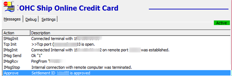

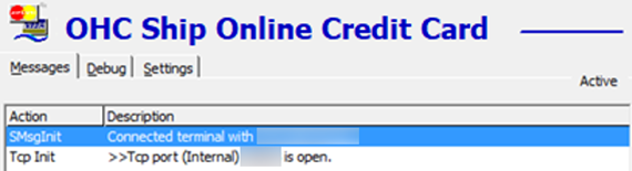

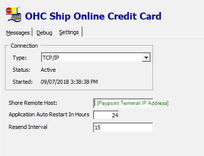

Start OHC Ship Transf.exe and navigate to the Settings tab.
Enter the Shore Remote Host IP address. The shore remote host is the Paypoint Terminal IP address.
Figure 5-2 OHC Ship Transfer — Setting Screen
The connection is shown in Message tab per below figure.
Figure 5-3 OHC Ship Transfer — Message Screen

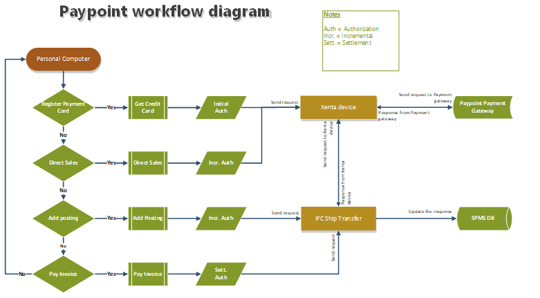

Paypoint Workflow
The SPMS application communicates with Paypoint device through a TCP/IP protocol and the device handles the communication with the host through its own network card. The IP address is stored in the Paypoint device itself.
Send Initial Authorization
Authorization requests performed at Management module, Get Credit Card or Advance Quick Check-in module, Get Credit Card/Direct Salesare sent to the Paypoint device before passing them to the Paypoint Payment Gateway.
Send Incremental/Settlement Authorization
An Incremental/Settlement request performed at Management module, Add Posting / Pay invoice function is sent to OHC Ship Transfer module before being passed to Paypoint payment gateway.
Figure 5-4 Paypoint Credit Card Handling Workflow

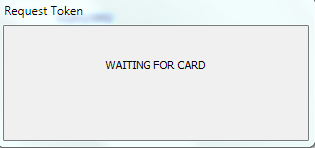

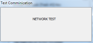

After the Save PED IP button is clicked, a Test Communication between the Management module and the device shall commence.
Figure 5-6 Management — Test Communication — In Progress
Figure 5-7 Management — Get Credit Card
When you click the Get Credit Card button at Guest Handling, the program communicates with the device and prompts to insert/swipe a credit card.

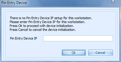

Setting up Device in Advance Quick Check-In module
At the start up the AQCI module and if the module has never been connected/configured with a card device, the Pin Entry Device screen without an IP address prompts ‘Enter the device’s IP address’ and click OK.
Figure 5-8 Advance QCI — Pin Entry Device

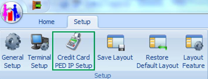

The AQCI program will run the Test Communication between AQCI and the card device when the OK button is clicked and you will receive a notification when the testing is OK.
To change or re-test the connection, navigate to the Setup tab, click the Credit Card PED IP setup at the ribbon bar and the Pin Entry Device IP screen shall prompt. Click the PED Overwrite button and enter the new IP address.
Figure 5-10 Advance QCI — Credit Card PED IP Setup

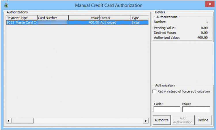

Viewing Authorization Amount in Management module
Log in to Management module and navigate to Guest Handling screen.
At the Search Panel, browse the guest account.

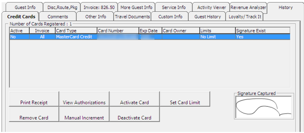

Navigate to the Credit Card tab of the guest account. The registered card status should be in Inactive mode.
Figure 5-11 Management Credit Card
To display the initial authorization, select the credit card and click View Authorization.
The Authorized Value shown in View Authorization is the last authorization amount, excluding the amount from Direct Sales.
Figure 5-12 Management View Authorization

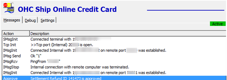

OHC Ship Transfer (Sample Response Message)
Below are the samples response message in OHC Ship Transfer.
Send Authorization
Figure 5-14 OHC Ship Transfer — Send Request Message — Send Authorization
Send Settlement
Figure 5-15 OHC Ship Transfer — Send Request Message — Send Settlement
