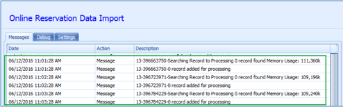

Refresh Interval
Figure 5–1 below shows the system constantly checks for new records to process every 60 seconds or per a defined interval time.
Figure 5-1 Sample Refresh Interval Messages
This figure shows the sample refresh interval messages logged by DGS.

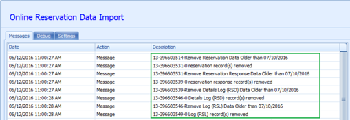

Delete reservation data older than 60 Days
In the Messages tab, data older than 60 days from the date of modification is removed.
Figure 5-2 Sample Deleted Reservation Message
This figure shows the sample messages of deleted reservation.

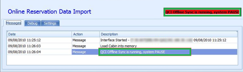

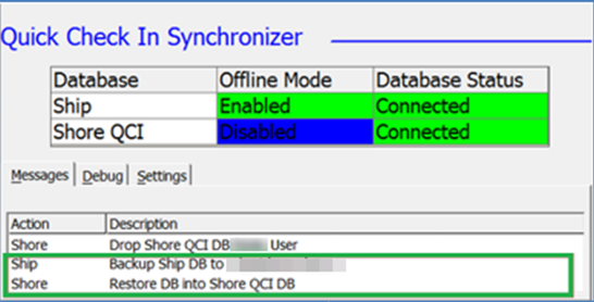

Stop process when QCI Offline Sync is enabled
This parameter backs up and restores the latest database to the QCI Shore Database when the parameter is enabled and the QCI Sync Interface is started.
At the point when Quick Check In Synchronizer Ship database mode is in an Enabled status in Offline Mode, the DGS ResOnline Interface status switches to a Pause and resumes when the Offline Mode is Disabled.
Figure 5-4 QCI Synchronization Status
This figure shows the QCI Synchronizer Status when when QCI Offline Sync is Enabled.
Figure 5-5 DGS Pause Mode
This figure shows the DGS Pause Mode when QCI Sync is running

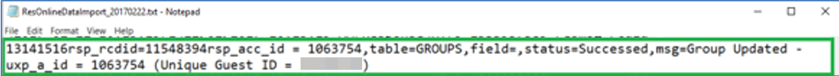

Only process UCIData with account check in status = 0
Below is the sample message of UCIData when the parameter value of ‘Only Process UCIData With Account Check In Status’ is set to 0 and the option is checked in the application.
Figure 5-7 Sample Message of Only Process UCIData With Account Check In Status
This figure shows the sample message of UCIData when the parameter value of ‘Only Process UCIData With Account Check In Status’ is set to 0 and option is checked in the application.

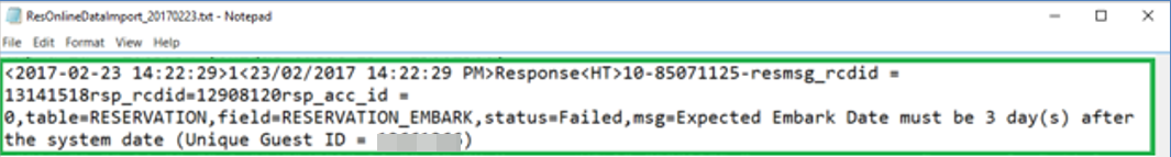

Stop Reservation Update x Days Before Embarkation
This parameter stops the import of reservation updates based on the number of days defined in the parameter and logs a fail message, ‘Expected Embark date must be x day(s) after the system date.’
For example, the number of days defined before embarkation is three and record with embark date less than or equal to three days after the system date are not imported
Figure 5-9 Sample mMessage on Stop Reservation Update x Days Before Embarkation
This figure shows the sample message of Stop Reservation Update x Days Before Embarkation.

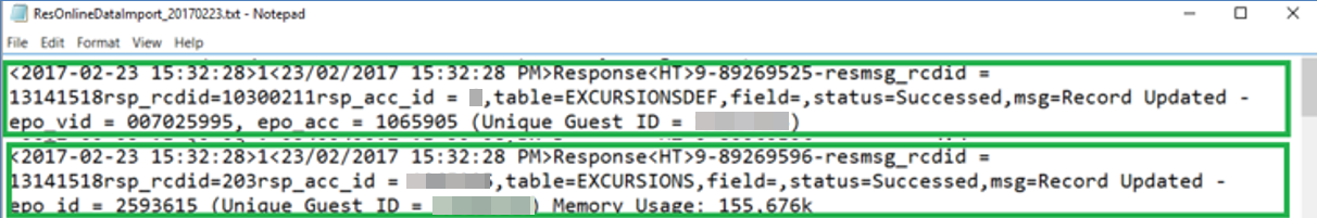

Allow Change Excursion/Ticket Date for the same tour
When this parameter is turned on and a date change is made to the same excursion, the system does not create a new booking but update the excursion date with new date sent by the interface.
When the data is sent with the same EPO_VID, ESE_ID=EPO_ESE_ID with different booking date, the EPO_ESE_ID and EPO_SDAT the updated the same record.
Figure 5-13 Sample message of Allow Change Excursion/Ticket Date
This figure shows the sample message of Allow Change Excursion/Ticket Date
