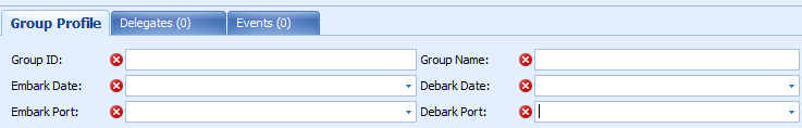

Adding Group Profiles
You would require a Group ID, Group Name, and Embark Date before you can create a profile.
  1. Click the Add from the menu bar to add a new main group. If the required field is empty, the system prompts an error.
  2. Enter all the necessary information and click Save to save the newly created main group.

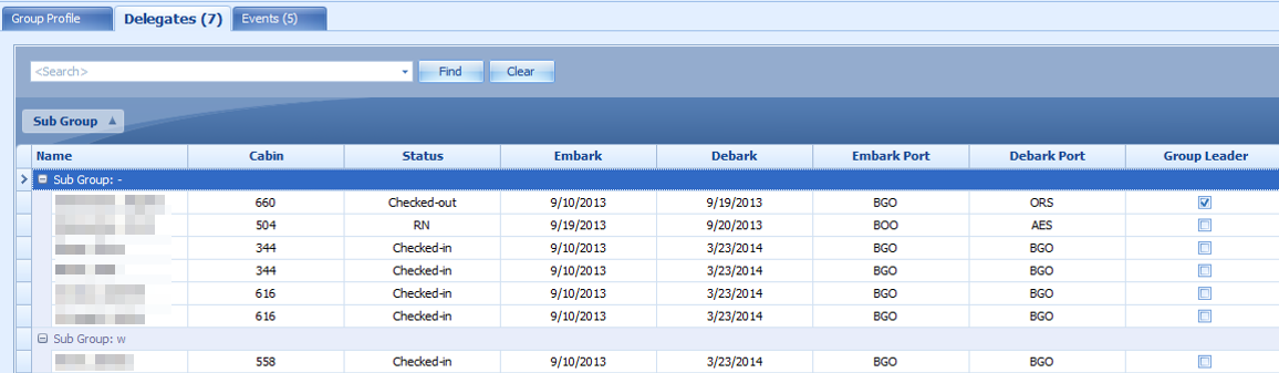

The Delegates tab lists all the delegations belonging to a main group and subgroups. Within this tab, you can assign a group leader for the group simply by selecting the group member and then clicking the Assign Group Leader on the ribbon bar.
Figure 5-3 Event Delegates Tab
This figure shows the Event Delegates tab
To unassign a group leader, select the group leader from the delegate list and click Unassign As Group Leader.

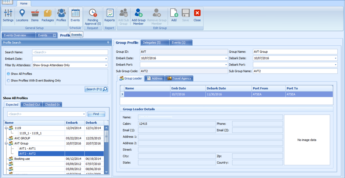

Editing Main Group Profile
  1. To edit group details, search the group using the search function on the left pane.
  2. Navigate to the Group Profile tab, edit the information, and then click Save at the ribbon bar.

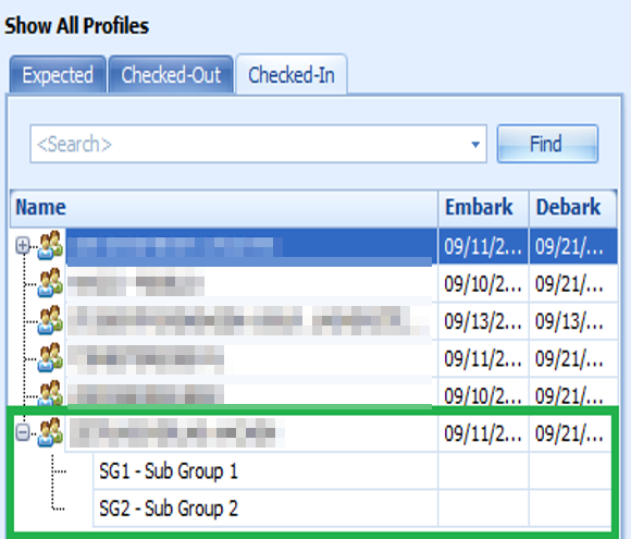

Adding a Sub-Group
A sub-group profile is used to manage multiple events within a group and is linked to the Main Group profile.
  1. Search the Main Group profile using the Profile Search, then select the Profile.
  2. Click the Add Sub Group from the menu bar to add a new sub-group.
  3. In the Sub-Group window, enter the Sub Group Code and Sub Group Name, and then click Save to save the newly created sub-group.
  4. At the confirmation prompt, click OK to return to the Profile window.

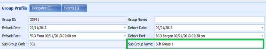

Editing Sub-Group
The information in the Sub Group Profiles is editable and is limited to Group Name, Embark/Debark Date, Embark/Debark Port, and Sub Group Name. Changing the Sub Group code is not allowed.
Figure 5-5 Sub Grop Name
This figure shows the Sub Group Name in Group Profile
To change the information, select the Sub Group Name from the profile listing, edit, and then click Save.

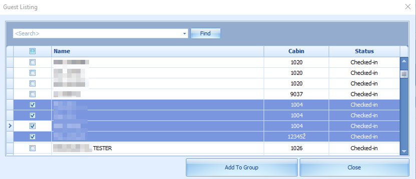

The Group Delegate function links all attending group members to the event. You can add a delegate through the Add Group Member function in Profiles, which then allows you to select the group members attending the event from the Event Attendees tab.
  1. Search for the event using the Profiles Search function on the left pane of Profiles.
  2. Click Add Group Member from the menu bar to launch the Guest List.
    Figure 5-6 Group Delegate List
    This figure shows the Group Delegate Listing
  3. In the Guest Listing window, select the guest by selecting the checkbox besides the guest name or use the search function to search for the name and return matching results highlighted in yellow. Click Add To Group. The new group member name(s) appear in the Delegates tab.
  4. Adding multiple delegates to an event is allowed. If you are adding a guest that belongs to another group, the system prompts a reassignment warning. Click Yes to confirm the reassignment.
