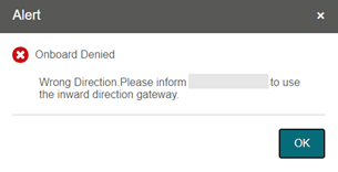

Wrong direction (occurs when a single direction is being used)
This alert message appears when the guest, resident, visitor, or crew passes through the gate in the opposite direction set up by the Security officer.
Figure 24-1 Example of Wrong Direction message
Inward
This error message appears when the security officer selects the direction as Inward and an onboard guest record to go ashore.
The default message is: Please inform <Profile’s name> to use the inward direction gateway.” The message for this can be changed from OHC Administration module Administration, System Setup menu, under Labels Setup and GNG007.

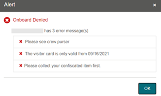

Coming Onboard Validation
Figure 24-2 Sample Onboard Denied Message
The following parameters are configured in the OHC Administration module, System Setup menu, Database Parameters.
Check Visitor Card: 0- No checking performed; 1- Check on the validity of visitor card.
Use Ashore Denied Message: 0- Do not use denied message in Ashore/Onboard Denied function; 1- Use.
Deny Boarding
This error message appears when Deny Boarding shows as YES and the Deny Boarding reason is entered from the OHC Management module, Cashier Handling, Guests tab, selected guest profile or the OHC Crew module, Crew Members, selected crew profile.
The default error message “<Salutation><Full Name> is not allowed due to <deny reason>”. You can define your error message from OHC Administration module, Administration menu, then System Setup, and Labels Setup, ODCT01.
Visitor Card is expired
This error message appears when the visitor estimates that the disembark date is earlier than the Cruise System Date and the “Check Visitor Card” parameteris is 1.
The default error message is “The visitor card is expired.” You can define your error message from OHC Administration module, Administration menu, System Setup, and Labels Setup, GNG039.
Visitor Card validity is in future date
This error message appears when the validity of the visitor’s card is after the embarkation date, and the “Check Visitor Card” parameter is set to 1.
The default error message is: “The Visitor card is only valid from <Profile’s Embark Estimated Date>”. You can define your error message from OHC Administration module, Administration menu, System Setup and then Labels Setup, GNG040.

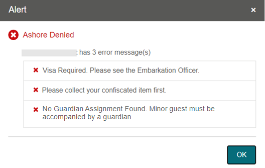

Shore Leave Denied
This error message appears when the guest is listed on the shore leave deny list and attempts to go ashore. The shore leave deny list is configured in OHC Management module, Cashier, Ashore Deny List or OHC Crew, Safety, Ashore Deny List.
To activate the shore leave denied feature, set the SLD Manual Override parameter to 1.
The default message shows the Ashore Denied header only. You can define the message from OHC Administration, Administration, System Setup, Labels Setup, and use GNG036 for Crew and GNG037 for guest or resident.
Visa Check
This error message appears when a travel visa is required for the guest, crew, visitor or resident to leave the ship. To activate the visa check, set the parameter Enable Visa Check to 1.
The visa requirements can be set up in these three modules:
OHC Administration, Security, Port/Visa Requirement
OHC Management, Security, Port/Visa Requirement
OHC Crew, Security, Port/Visa Requirement
The default error message is: “Visa required. Please see the Embarkation Offer.” You can define your message from OHC Administration, Administration, System Setup, Labels Setup, VMSG01.

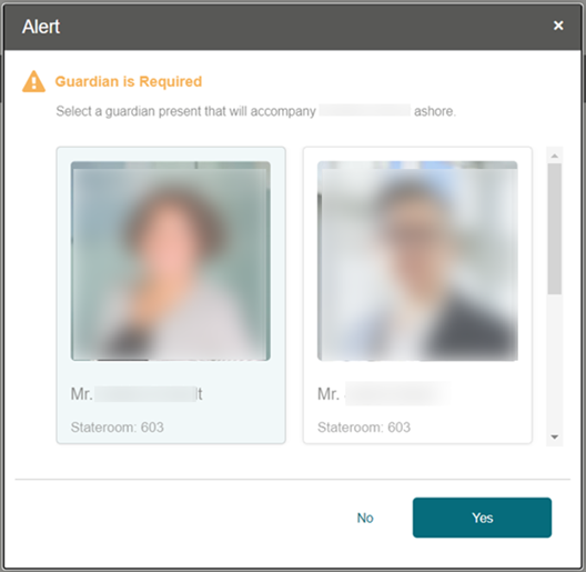

Minor validation
Assign Guardian to a minor
The Security Officer must verify whether the assigned guardian is accompanying the minor when the minor goes ashore.
Minor with pre-assigned guardian
If the guardian profile is assigned to a minor profile, the system displays the guardian list when the Security Officer processes the minor’s exit.
The default message is “Select a Guardian that will accompany <minor name> minor ashore.” You can define your message from OHC Administration, Administration, System Setup, Labels Setup, GNG116.
If the Security Officer is not able to find the guardian, the Security Officer will select No to disallow the minor from going ashore. The system displays: “A guardian should be physically present with <Minor Name> Minor.”
The default message is “Select a Guardian that will accompany <minor name> minor ashore.” You can define your message from OHC Administration, Administration, System Setup, Labels Setup, GNG117.
Figure 24-4 Guardian Listing

If the minor does not have a guardian assigned to the minor’s profile, the Security Officer will not allow this minor to go ashore.
The default message “No guardian assignment found. <minor name> is a minor and must be accompanied by an adult guardian.” You can define your message from OHC Administration, Administration, System Setup, Labels Setup, GNG072.

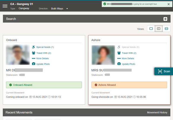

Overnight Tour Notification
If a guest, resident or crew purchases an excursion tour that requires them to stay overnight on the shore, the system brings up a notification indicating that the guest, resident, or crew is going for an overnight tour.
The overnight tour notification appears after the guest, resident, or crew successfully changes the onboard status to Ashore.
The default message is: “<guest name> is going for an overnight tour.” You can define your message from OHC Administration, Administration, System Setup, Labels Setup, GNG032.
Figure 24-5 Overnight Tour Notification
