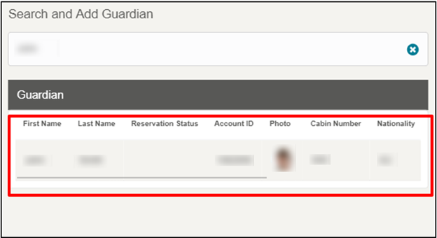

To add a guardian, select the guardian profile using the +Add button from the returned result page or scan the guardian RFID card. See section Search by Scanning RFID Cards
Figure 12-2 Assigned Guardian List
To remove a guardian, in the Guardian section, select the guardian profile and then click the X of the selected profile.
Once you have confirmed the Guardian Information, click Next to complete the Guardian page.
