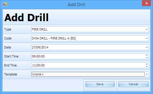

Setting up a Drill
Before you can assign the crew to the drill, you must schedule all drills in the Drill Mode.

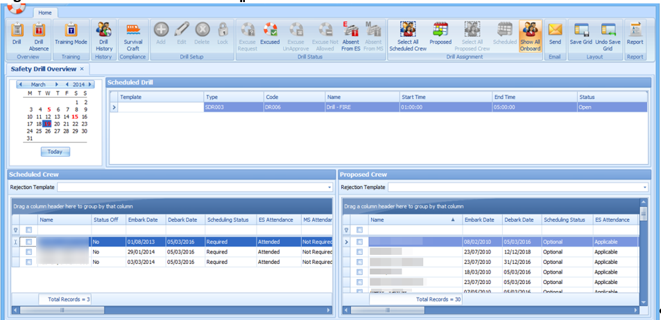

At the Safety Drill Overview window, select a date from the calendar editor.
Click the Add button at the ribbon bar to add a new drill.
Figure 1-2 Add Drill Window
Table 1-1 Add Drill Field Description
Field Name Description Type
Displays the drill definition without courses and certificates assigned. Refers to Drill Type setup.
Code
Displays all definitions linked to Drill Definition setup of the selected drill type.
Date
Planned drill date.
Start Time
The drill scheduled start time
End Time
The drill scheduled end time
Template
Proposed eligible crew to the scheduled drill based on Safety Department, Safety Position, Safety Group and Safety Function assigned in the Drill template, and all templates setup in Drill Template are shown.
At the Add Drill window, select the Type, Code, Date, Start/End Time, and Template from the drop-down list.
Click the Save button to save the drill. Dates that have scheduled drills are shown in red on the calendar.

At the Safety Drill Overview window, select the drill date from the calendar.
Click the Edit at the ribbon bar and select a new date, and start/end time from the drop-down list.
Click the Save button to save the record.

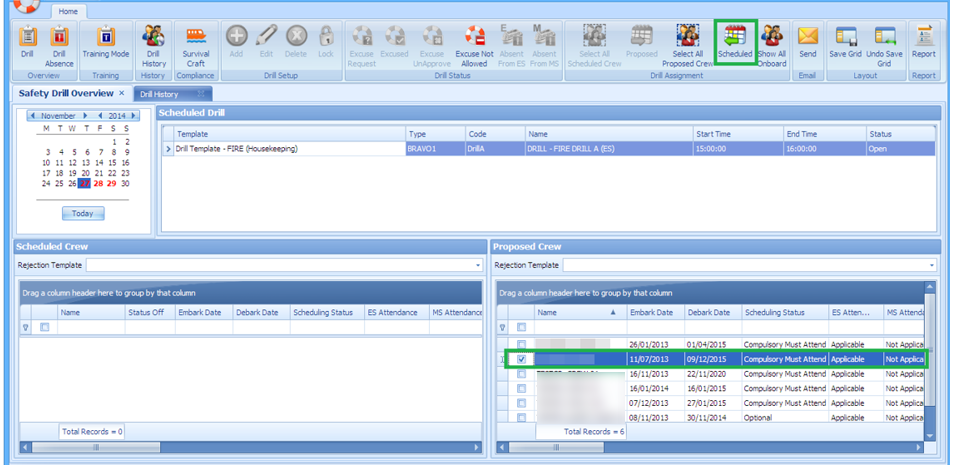

Select the Drill Date from the Safety Drill Overview, Calendar.
Select the drill in the Schedule Drill section to populate the Crew due for drill in the Proposed Crew grid.
At the Proposed Crew grid, select the checkbox next to the name to select the crew or click Select All Proposed Crew at the ribbon bar to select all crew.
Click the Scheduled button to assign. The selected crew name will appear in the Scheduled Crew grid.

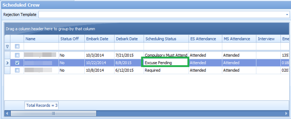

A crew might be excused from attending the drill or absent for a reason. By default, the attendance of the crew in the Scheduled Crew grid is Attended. The Chief Safety Officer or his/her assistant is responsible in managing the crew attendance for the drill, and the following sections describe the available status.

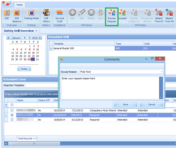

Setting an Excuse Request
An Excuse Request function is only available to a crew that has Scheduling Status equals to Required. This function is not applicable to a crew that has Compulsory Must Attend status.
Figure 1-4 Excuse Request Window
Select the crew from the Scheduled Crew grid with the Required status.
Click the Excuse Request at the ribbon bar.
The system prompts an Excuse Request Reason input window. Select the reason from the drop-down list.
Click the Save button.
Click the Excused button at the ribbon bar. The crew Scheduling Status now resets to Excused.

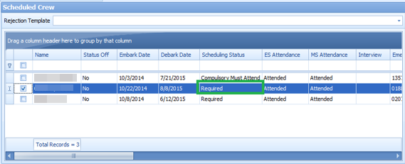

Resetting an Undo Excused Status
The Undo Excuse function is only available to crew with Scheduling Status set to Excused.
Select the crew from the Scheduled Crew grid with the Excused status.
Click the Undo Excuse button on the ribbon bar. This resets the status to Required.

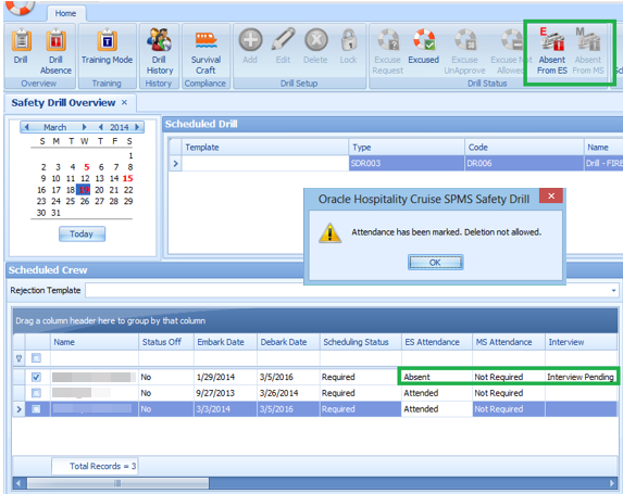

Setting an Absent from ES/MS
The Absent setting from the ES/MS function records the absenteeism of the crew scheduled for a drill. An interview is scheduled when the attendance is marked as absent.
Figure 1-7 Absent From ES/MS
Select the crew from the Scheduled Crew grid.
Click the Absent From ES or Absent From MS button on the ribbon bar, depending on the drill attendance of the crew.
The Scheduling Status resets to Absent. In the Interview column, the status is set to Interview Pending. Removing a crew with the Absent status is not allowed and prompts a message stating “Attendence has been marked. Deletion not allowed” when you try to remove the crew from the schedule.

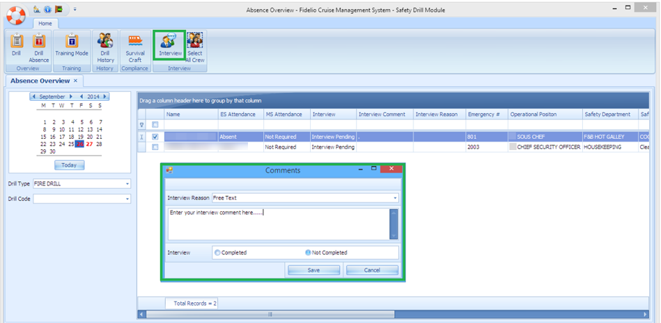

Drill Absence
The Drill Absence manages absentees from the scheduled drill. By default, the crew attendance is set to Attended at scheduling and absent is marked at the end of the drill.
A list of absentees can be extracted by Drill Type, excluding those that were set as Excused from the drill.
Figure 1-8 Drill Absence Overview
Select the Drill Absence from the ribbon bar.
Select the drill date from the Calendar tab.
Select the Drill Type and/or Drill code from the drop-down list. If the drill code is blank, the system displays all absentees for that date.
From the Absentees list, select a crew name and click Interview.
At the Interview Comment dialogue box, select the Interview Reason from the drop-down list, and enter the comments or for manual input select Free Text.
At the Interview status, select Completed or Not Completed.
Click the Save button. Once the status is set to Completed and saved, change is not allowed.
