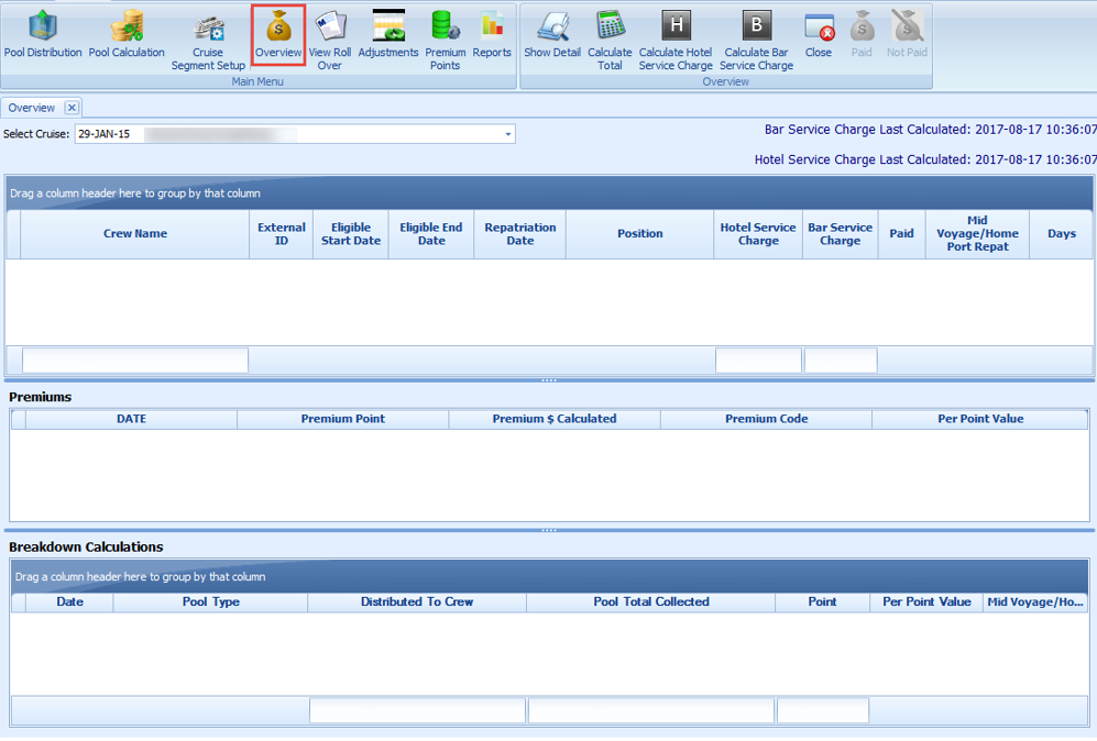

The Service Charge module calculates the total Hotel Service Charge (HSC) or Beverage Service Charge (BSC) of the day, then divides by the total pool points for the day before adding each day’s calculation to obtain the voyage total.
Figure 3-1 Service Charge Overview
This figure shows the Service Charge Overview screen.

  1. Click the Overview button to access the Service Charge Dashboard.
  2. The Service Charge Dashboard window appears blank when you first open. Click Show Details to populate the information.
  3. The window is divided into three (3) sections. The columns and width of these sections are adjustable by dragging the column divider.
  4. If there are no HSC or BSC posting to the voyage at the time the Calculate Total button is first pressed, no crew members will appear in the list. The BSC list appears only when the BSC has been charged and not HSC or visa-versa.

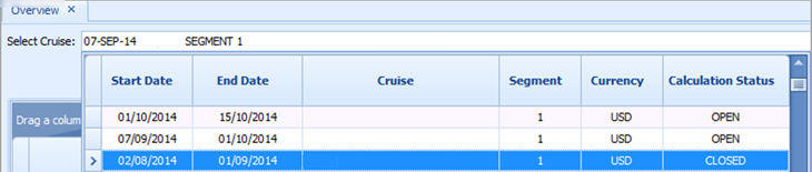

Figure 3-2 Open Status of Prior Voyage
This figure shows the warning notification that the prior voyage status is still open.
The date of the voyage status changes to Close becomes the Last Calculated date that appears in the Select Cruise drop-down list. Therefore, for reporting clarity it is best to maintain the last calculated date as the actual voyage or segment end date.
Figure 3-3 Segment Status
This figure shows the calculation status by cruise segment.
