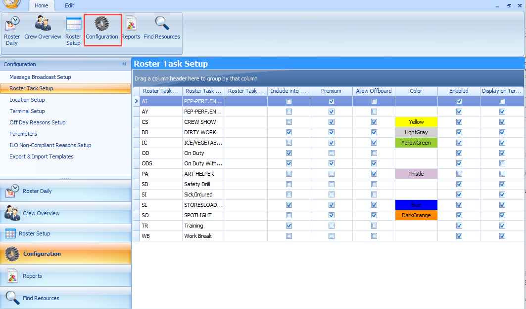

Accessing the Configuration Menu
Log in to the T&A module.
At the Home tab, select Configuration from the ribbon bar.
The type of setup available to T&A module is listed on the Configuration window.
Go to Edit tab and select a code to set up.
Roster Task Setup
OD: On Duty
ODS: On Shore side Duties
SD: Safety Drill
SL: Sick/Injured
TR: Training
Select Roster Task Setup from the Configuration window.
Select Add to open the Add Roster Task window.
Insert the Code, Name, Description, and select the Color code from the drop-down list.
Select the applicable checkboxes and click Save.
Table 2-1 Field Definition of Roster Task
| Field name | Description |
Color Code |
Representation of task in Schedule or Monthly Overview window. |
Include into Working Hours |
Takes into account the over time (OT) work hours and hours worked (ILO) when calculating the total work hours. |
Premium |
Defines the work hour as premium paid hours. The hourly premium work rate is set up in the Payroll module, Maintenance, and Interfaced Paycodes. Premium roster task is accountable in Service Charge calculation and deducts from total pools before distributing the pool to all entitled crews. |
Allow Offboard |
The crew assigned to this roster task is allowed to go ashore. Otherwise, they are flagged as Shore Denied. |
Display on Terminal |
The task is displayed in T&A Terminal and available for crew scheduling. |
Enabled |
By default, the newly added task is active. |

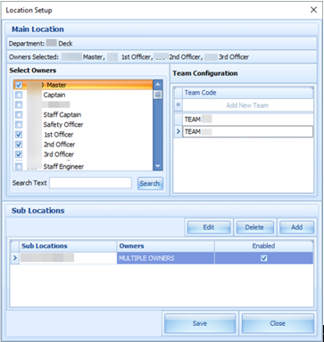

Location Setup
Figure 2-2 Location Setup
The Location Setup window populates the location configured in Administration, Operational Division Setup. Adding/editing is not permissible. However, this function permits you to assign an owner(s) to the specific location or add a sub-location.
From the Configuration window, select the Location Setup.
Select the location to edit by double-clicking or click Edit on the ribbon bar.
At the Location Setup window, select the owner(s) by selecting the respective checkboxes. Use the Search Text field to search for the specific owner or scroll through and select the owner.
At the Sub Locations section, click Add.
Enter the Sub Location code, Name and Description.
Select the Deck checkbox and select the Deck Code, if any.
Select the Owners and click Save to save the sub-location.
Click Save to save and close the Location Setup window.
