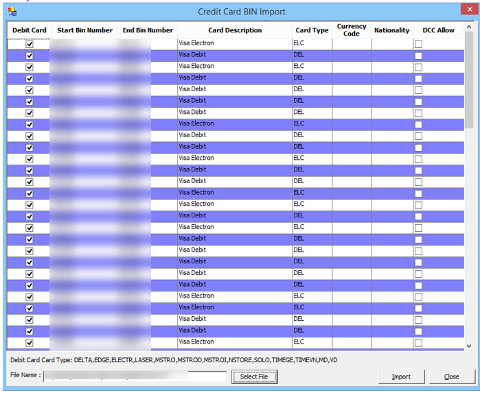

Importing Credit Card BIN
In order for the program to determine the correct card type (Credit/Debit) and its handling, you must mport a Credit Card Bank Identification Numbers (BIN) in the file into SPMS. This file contains the complete set of eligible BIN range and is provided periodically by ELAVON. When the BIN file reloads, all previously loaded information is overwritten during the process.
Loading the BIN File
to the Administration module and select Financial SLoginetup, Import Credit Card Bin file.
Locate and select the latest BIN File from the folder. For example, see section Sample BIN file.
Figure 6-1 Credit Card BIN Import Screen
The BIN file information populates in the Credit Card BIN Import screen. Click Import to save the BIN ranges into the BIN table and Close to exit.

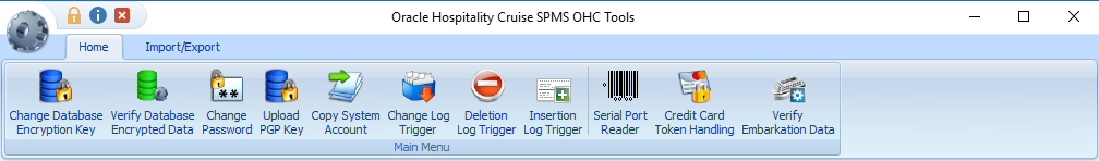

Setting up PGP Encryption
Run OHC Tools and select Upload PGP Key to upload PGP key pair for DCC handling.
Figure 6-2 OHC Tools Menu

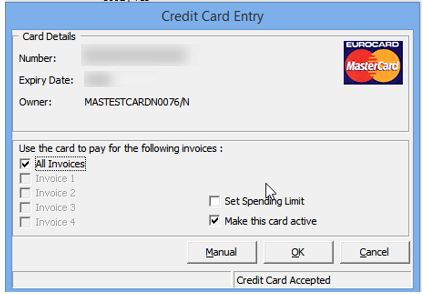

Select a checked-in guest and click Get Credit Card button in the Guest Handling screen.
The system will prompt a message requesting the card to be swiped. Swipe the card through the card slot of the card device.
After the card is swiped, the credit card information and its status are reflected on the credit card entry. If the credit card is valid, the credit card accepted status is shown on the screen.

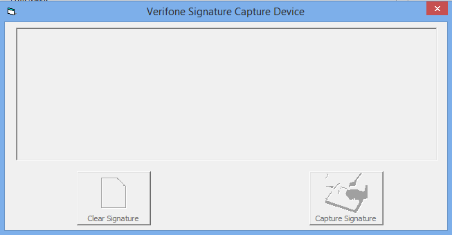

To use the Signature Capture feature, the Enable Signature Capture for Credit Card parameter and the Signature screen will prompt when the card is registered at both the Management module and the device.
Figure 6-7 Signature Screen at Module
After the guest places their signature on the device, click Enter to complete the credit card registration process. If Cancel is pressed, you will receive a No Signature Received promptly in Guest Handling screen.
A Transaction Completed screen appears on the device when the registration completes or Transaction Cancelled appears when the Cancel button is pressed.
The signature captured is shown on the signature screen. Clicking the Clear Signature button resets the signature and allows the guest to place a fresh signature.
Click the Capture Signature button to complete the credit card registration on the guest account.

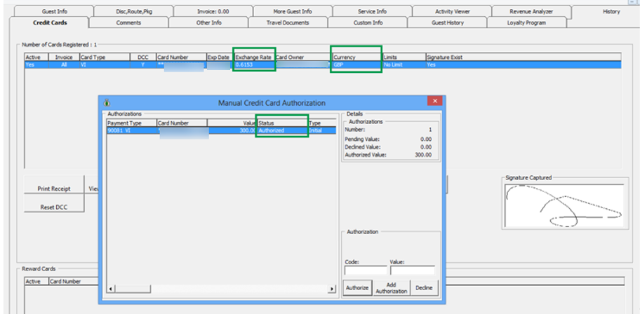

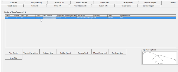

The registered credit card details are stored in the Credit Card tab of Guest handling screen, with the DCC column flagged with ‘Y’ when the card is enrolled with DCC. At the Signature Captured column, the signature captured during the credit card registration is shown. The program does not allow credit card registration without a signature when Enable Signature Capture for Credit Card parameter is enabled.
Figure 6-8 Guest Handling Credit Card Screen

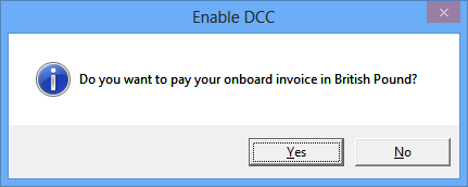

For DCC handling, the folowing message box will prompt when the ‘Card Reader Type’ is assigned to a magnetic swipe device. This shows that the credit card is eligible for DCC enrollment.
Figure 6-9 DCC Enable Screen — Manual Card Swipe
Click Yes to enroll the DCC handling or No to register the credit card without DCC handling.

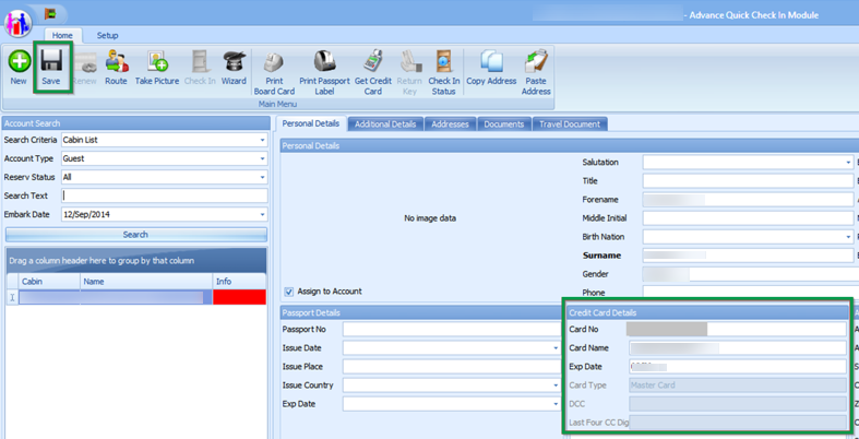

Run OHC Advanced Quick Check In (AQCI).
At the ribbon bar, select the Setup tab, General Setup, Hardware tab.
At the Hardware tab, Card Reader #1 section, a port number is assigned. The port number in AQCI always shows the assigned port number that is different from OHC Management.
Select the device from the drop-down list. The Get Credit Card button is enabled at the ribbon bar after you assigned the device.
Clicking the Get Credit Card button after selecting a checked-in passenger will prompt a Please Swipe Card notification on AQCI screen.
After the card is swiped, the credit card details populate in the respective field of Credit Card Details section.
Figure 6-10 AQCI Credit Card Section
Click Save to proceed with the registration. If the credit card is eligible for DCC (Dynamic Currency Conversion) enrolment, the system prompts the DCC handling message, requesting you to select the currency on the device.

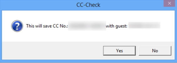

At the AQCI screen, select Yes at the confirmation to write the card details into the database.

The initial authorization amount refers to Minimum Authorization in Credit Card Financial Setup. -
After you click the Process button, an Authorization file is generated and encrypted with a PGP key.
Figure 6-14 Sample PGP Encrypted Authorization File

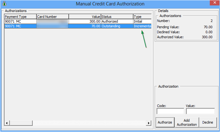

Status for the pending approval authorization transaction is Outstanding, and the transaction can be traced in Management module, Guest handling, Credit Card tab, View Authorization.
Figure 6-15 Credit Card Authorization in Management module

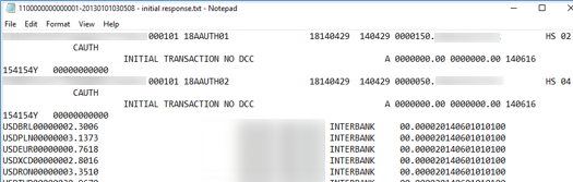

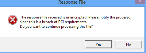

Reading an Authorization
After you have obtained the response file from the merchant, at the Authorization menu, select DCC Read Increment File.

If the response file is not encrypted, an alert message box will prompt. Select the appropriate response.
Figure 6-16 Non-encrypted Response File
You will receive a batch with currency exchange rate provided by the merchant. See the figure below for sample.
Figure 6-17 Sample Response File with Currency Exchange Rate

After the authorization completes, the authorization status in Guest Handling, Credit Card tab, View Authorization is updated to Authorized, with the exchange rate provided in the response file. The exchange rate is also stored in the DCC table.
Figure 6-19 OHC Management — Credit Card Tab

In the Guest Handling, Credit Card, View Authorization screen, the status of the unconverted incremental authorization amount is listed as Outstanding status.
To change the status to Authorize, see Reading an Authorization.
Figure 6-21 View Authorization with Incremental Authorization — Pending Approval

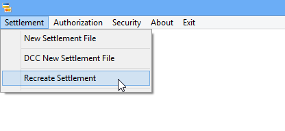

Click the Recreate Settlement from the Settlement menu.
Figure 6-28 Settlement Menu — Recreate Settlement
