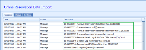

Delete reservation data older than 60 Days
In the Messages tab, data older than 60 days from the date of modification is removed.
Figure 5-2 Sample Deleted Reservation Message

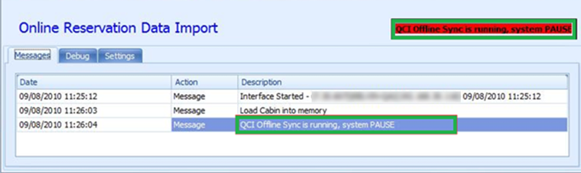

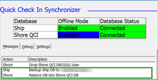

Stop process when QCI Offline Sync is enabled
This parameter backs up and restores the latest database to the QCI Shore Database when the parameter is enabled and the QCI Sync Interface is started.
At the point when Quick Check In Synchronizer Ship database mode is in an Enabled status in Offline Mode, the DGS ResOnline Interface status switches to a Pause and resumes when the Offline Mode is Disabled.
Figure 5-4 QCI Synchronization Status
Figure 5-5 DGS Pause Mode

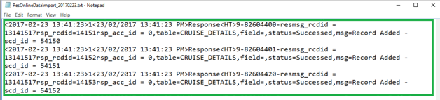

Do not import cruise (SCR), only import cruise details (SCD)
When this parameter is enabled, the system only imports the cruise details excluding the cruise date.
Figure 5-6 Sample Do Not Import Cruise Details Messages

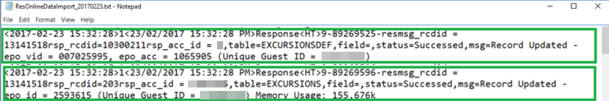

Only Update Cruise ID, Department, Net Price and Sales Price For Excursion/Ticket
The system only updates the cruise ID, department, net price, and sales price for excursion when the parameter is selected, and no other changes shall take place. The example below shows the price value has been updated.
Figure 5-12 Sample message of Update Cruise ID, Department ID, Net Price
