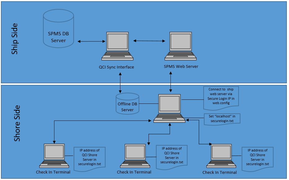

The diagram below illustrates the data flow for QCI Offline Check In environment at the Shore Side.
Figure 2-1 Environment Setup
Environment Setup for PC Running QCI Sync Interface

The server must be pre-installed with SPMS Web Service. Define the Ship WebService IP at SecureLogin, web.config file. This is to obtain the encryption password (OHCSecurity.par) from the ship’s web service when connected.
Figure 2-2 QCI Sync WebService Configuration
The server must be pre-installed with SPMS for OHC Advanced Quick Check In to run and connect to the Shore Database. The securelogin.txt must point to QCI Shore Database Server’s web server. This is to obtain the encryption password (OHCSecurity.par) from ship’s web service and store in the QCI Shore Database Server’s Web Server.
