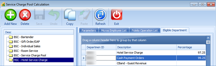

Cash Payment Order Calculation
At Service Charge Pool Calculation, create the new debit department for CPO posting.
Define the percentage to distribute in Pool Calculation, Eligible Department setup under the same Pool Distribution type.
Figure 6-1 Service Charge Pool Calculation
In the following example, the Cash Payment Order department = 99.25%. Amount collected only calculates the provision fees of 0.75%. The exempted credit card fees of 2% (100% - 0.25%).
Amount collected from Hotel Service Charge department = $20798.66 (posting $21386.8 x 97.25%).
Amount collected from CPO department = $526.03 (posting $530 x 99.25%).
Total Amount collected for pool distribution = $21324.69.
