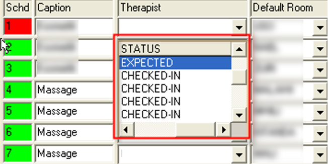

Therapists Schedule Information
In the same way as for Location Schedule, the appropriate therapists are loaded from the Therapists Setup into the Therapists drop-down selection boxes, allowing you to assign the appropriate therapist to each schedule at a later time.
Red: for Expected Therapists (and for schedules that are not link to any Therapists).
Green: for Checked-In Therapists.
Each displayed Therapist's tool tip text shows either Expected or Checked-In next to the existing Expected Disembarkation Date.
Inside the Therapists drop-down selection box, you will find an additional Status column next to each therapist’s name (Expected or Checked-In).

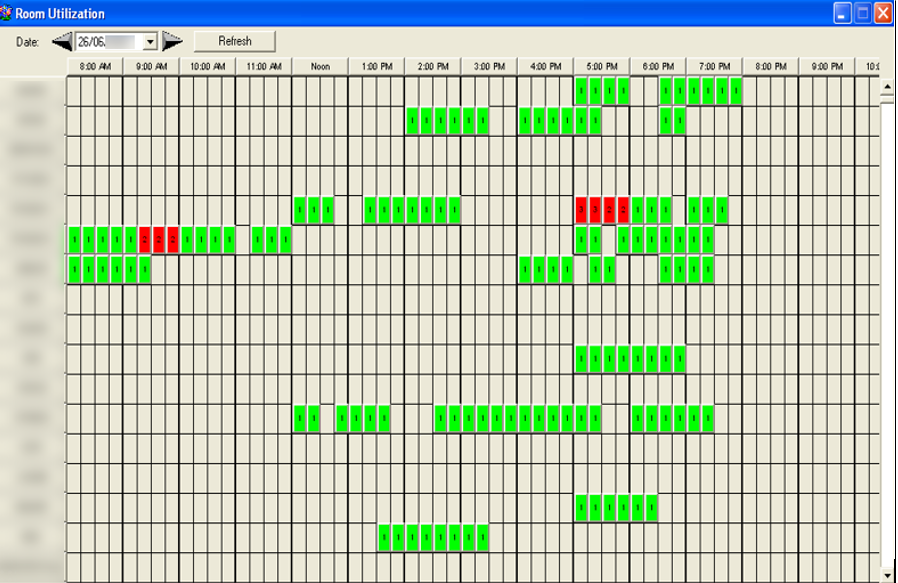

The blocked times appear in the default gray / dark gray / dark green and black colors.
All other Treatment Reservations (Expected and In House) are in yellow.
Only Expected and In House Treatment Reservations appear here since this is a pure availability overview.Multiple Discount Periods

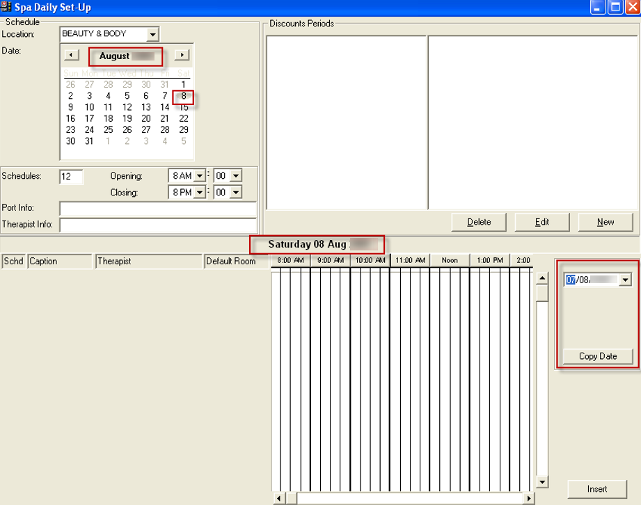

Setting up a Day
To set up a Day, select the Location and Date from the calendar.
As soon as you click on the Calendar into a Date that does not exist as a Spa Location Daily Schedule, the system loads the default values for the Location as found in the Location Maintenance as well as in the Therapists Setup.

Copying a Previous Day
To avoid setting up each single working day, the system provides the functionality to set up a Day by copying the setup of an existing working Day.
Select the date you want to set up from the calendar. The system displays an empty Working Day as well as the option to select an existing Working Day and copy this day’s setup into the selected empty setup.
Figure 4-2 Spa Daily Setup
Select the working date you want to copy the setup from and then click Copy Date.
The copy process begins immediately, and the date will have the same setup as the one you copied from.
Additionally, the system displays two more buttons: the Update button updates the proposed/ copied setup, the Remove Date button removes the proposed setup.
Click on Remove Date to remove the Daily Setup for the selected day. The following appears “Are you sure you want to remove the Daily Setup for selected Date: 08/08/2019”

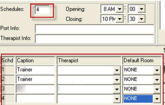

Adding and Removing Schedules
The function allows you to add additional schedules and therapist to the selected date.
Figure 4-3 Schedules
Place the cursor in the Schedules text box and replace the number as shown in above figure from four (4) with six (6) and click Tab. The system will create two additional schedules where you can enter their captions as well as select therapists and default rooms
After finishing all necessary changes, click Update to save. You can remove existing Schedules from a Daily Setup the same way, by reducing the Schedules number and clicking the Tab key. Clicking Yes, will remove the last two Schedules and reduce the total number of schedules for this working date to four.
When you try to remove a Schedule that already has Appointments or Blocked Times assigned, the system will not allow it and will display the following warning message “There are already appointments for one of the schedules you are trying to delete. Cannot continue.”Assigning Crew Member to Schedules
When adding Schedules into the Daily Setup, the system by default leaves the Captions, Therapists, and Default Rooms empty.
You can assign Therapists to those Schedules by selecting the therapist from the Therapist drop-down combo box and then clicking Update.

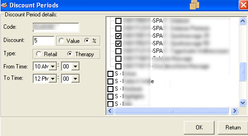

Creating and Editing Multiple Discount Periods
The assignment of Groups and Items works in the same way as the assignment of Trained Therapies in the Therapists Setup screen. You can assign to each Discount Period an entire Group of Items or selected Items.
This can be done during the creation of a Discount Period (New) or when editing an existing Discount Period (Edit).
Code: Enter a short description for the new Discount Period. This is used later to describe this Discount Period in the Reservations and Posting screen.
Discount: Enter the amount of the Discount and its type: Value.
Percentage (%): 2.50 or 10 percent.
Type: Select whether this Discount Period will include Retail.
Therapies Items: Clicking on each type results in automatic loading of Retail or Therapies Groups and Items on the right side tree view listing.
From Time: Enter the starting time of the Discount Period.
To Time: Enter the ending time of the Discount Period.
Select the check box of a Group to select the entire Group and all items belonging to the Group.
Double-click on the Group to expand the listing to display the individual items that each Group contains and to select specific items to include into the Discount Period.
Figure 4-4 Discount Periods
Click OK create this Discount Period and save it into the current displayed Date. The Daily Setup screen will be automatically updated to display the addition of the new Discount Period.
To edit some or all of the information of a Discount Period, simply click on Edit.
The same window as before will open to edit the information you wish the change. Clicking on OK will save the changes and will update the Daily Setup screen automatically.

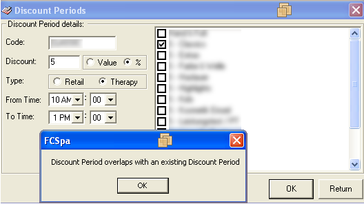

Discount Periods Overlaps
The Discount Periods functionality has a limitation in multiple Discounts Periods overlapping. Discount periods of the same type (Retail or Therapies) cannot be overlap or the system will not accept multiple periods existing for the same type in the same or overlapping period with another Discount Period of the same type.
In other words, looking at the screen above, we are having 2 Discount Periods for Therapies.
The first is CLASSIC from 10:00 – 12:00 for 5% for the 2 SPORT MASSAGE Therapies.
The second is HARMONY from 12:00 – 17:00 for 20% for all Therapies.
If we try to extend the ending time for the first period – CLASSIC – from 12:00 to 13:00, we will get the following message.
Figure 4-5 Discount Periods Overlap
In other words, looking at the screen above, we are having two Discount Periods for Therapies.
The first is CLASSIC from 10:00 – 12:00 for 5 percent for the two SPORT MASSAGE Therapies.
The second is HARMONY from 12:00 – 17:00 for 20 percent for all Therapies.
If trying to extend the ending time for the first period – CLASSIC – from 12:00 to 13:00, he following message appears “Discount Period overlaps with an existing Discount Period.”
The system allows you to create new Discounts Periods for Retail Items as needed, as long as they do not overlap with the existing one from 10:00 – 14:00.
