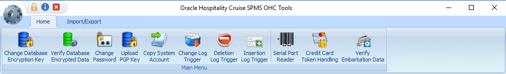

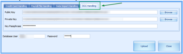

  1. Run OHC Tools and select Upload PGP Key to upload PGP key pair for DCC handling.
    Figure 6-2 OHC Tools Menu
    This figure shows the OHC Tools Menu
  2. At the PGP Key Uploaded screen, navigate to the DCC handling tab.
  3. Browse for the bank public key (file format is .pkr) under Public Key column.
  4. Browse for the secret key (file format is .skr) under Private Key column.
  5. Enter a Key Passphrase if the key pair is generated with a passphrase.
  6. Enter Ship’s database username and password.
    Figure 6-3 PGP Key Uploader — DCC Handling Tab
    This figure shows the PGP Key Uploader — DCC Handling Tab
  7. Click the Upload button to begin the key upload for DCC Handling.
  8. Upon successful upload, the system prompts a message box. Click OK to close and exit.

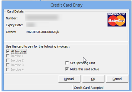

  5. After the card is swiped, the credit card information and its status are reflected on the credit card entry. If the credit card is valid, the credit card accepted status is shown on the screen.
    Figure 6-5 Credit Card Entry Details
    This figure shows the Credit Card Entry Details
  6. The processing screen displays during the credit card registration in the Credit Card Entry screen.

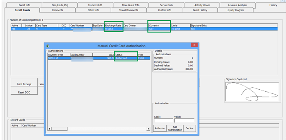

    The Currency Exchange rate used refers to the DCC table and exchange rate imported from the authorization response file.
    If the credit card is eligible for Dynamic Currency Conversion (DCC) and is within the DCC BIN range, the program prompts the DCC handling message box, followed by the currency selection screen
  7. Select the available Card Billing Currency for the credit card to enroll into the DCC handling prompt for acknowledgement of the DCC’s Term and Conditions clause on the card device.
  8. Click the Decline prompt on the device to terminate the credit card enrollment and save the credit card data into the database. Before saving the credit card data, it will prompt for signature if the Enable Signature Capture for Credit Card parameter is enabled.
  9. Click Acceptto enroll the credit card in DCC Handling. The system prompts a confirmation to save the credit card data. Click Yes to proceed.

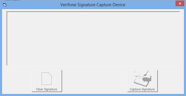

  12. To use the Signature Capture feature, the Enable Signature Capture for Credit Card parameter and the Signature screen will prompt when the card is registered at both the Management module and the device.
    Figure 6-7 Signature Screen at Module
    This figure shows the Signature Screen at Module
  13. After the guest places their signature on the device, click Enter to complete the credit card registration process. If Cancel is pressed, you will receive a No Signature Received promptly in Guest Handling screen.
  14. A Transaction Completed screen appears on the device when the registration completes or Transaction Cancelled appears when the Cancel button is pressed.
  15. The signature captured is shown on the signature screen. Clicking the Clear Signature button resets the signature and allows the guest to place a fresh signature.
  16. Click the Capture Signature button to complete the credit card registration on the guest account.

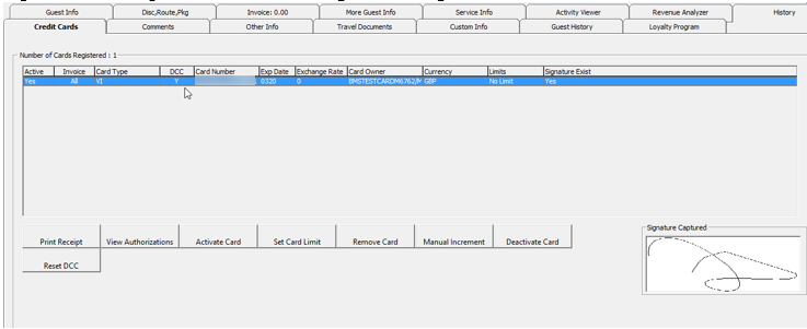

  18. The registered credit card details are stored in the Credit Card tab of Guest handling screen, with the DCC column flagged with ‘Y’ when the card is enrolled with DCC. At the Signature Captured column, the signature captured during the credit card registration is shown. The program does not allow credit card registration without a signature when Enable Signature Capture for Credit Card parameter is enabled.
    Figure 6-8 Guest Handling Credit Card Screen
    This figure shows the Guest Handling Credit Card Screen

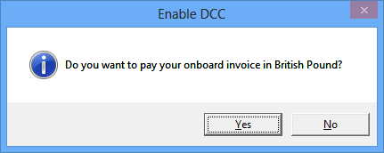

  19. For DCC handling, the folowing message box will prompt when the ‘Card Reader Type’ is assigned to a magnetic swipe device. This shows that the credit card is eligible for DCC enrollment.
    Figure 6-9 DCC Enable Screen — Manual Card Swipe
    This figure shows the DCC Enable Screen — Manual Card Swipe
  20. Click Yes to enroll the DCC handling or No to register the credit card without DCC handling.

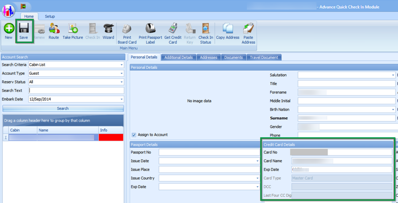

  1. Run OHC Advanced Quick Check In (AQCI).
  2. At the ribbon bar, select the Setup tab, General Setup, Hardware tab.
  3. At the Hardware tab, Card Reader #1 section, a port number is assigned. The port number in AQCI always shows the assigned port number that is different from OHC Management.
  4. Select the device from the drop-down list. The Get Credit Card button is enabled at the ribbon bar after you assigned the device.
  5. Clicking the Get Credit Card button after selecting a checked-in passenger will prompt a Please Swipe Card notification on AQCI screen.
  6. After the card is swiped, the credit card details populate in the respective field of Credit Card Details section.
    Figure 6-10 AQCI Credit Card Section
    This figure shows the AQCI Credit Card Section
  7. Click Save to proceed with the registration. If the credit card is eligible for DCC (Dynamic Currency Conversion) enrolment, the system prompts the DCC handling message, requesting you to select the currency on the device.

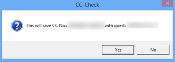

  9. At the AQCI screen, select Yes at the confirmation to write the card details into the database.

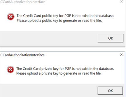

When the PGP Key Pair does not exist in the database, and the Process button is clicked, a message box per the following figure will prompt prohibiting you from generating an authorization file.
Figure 6-12 PGP Does Not Exist Message Prompt
This figure shows the PGP Does Exist Message Prompt

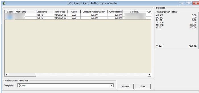

  1. At the Authorization menu, click the DCC New Incremental File to list all the credit cards requiring authorization that are flagged with DCC= “Y” on the DCC Credit Card Authorization Write screen.
    Figure 6-13 DCC Credit Card Authorization Write Screen
    This figure shows the DCC Credit Card Authorisation Write Screen
    The initial authorization amount refers to Minimum Authorization in Credit Card Financial Setup.
  2. After you click the Process button, an Authorization file is generated and encrypted with a PGP key.

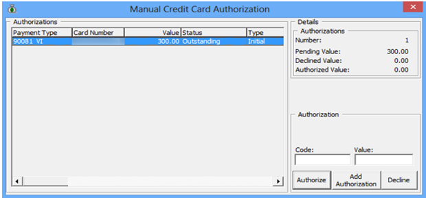

  3. Status for the pending approval authorization transaction is Outstanding, and the transaction can be traced in Management module, Guest handling, Credit Card tab, View Authorization.
Figure 6-15 Credit Card Authorization in Management module
This figure shows the Credit Card Authorization in Management Module

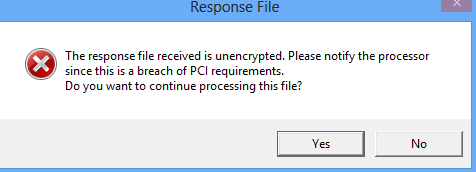

  3. If the response file is not encrypted, an alert message box will prompt. Select the appropriate response.
    Figure 6-16 Non-encrypted Response File

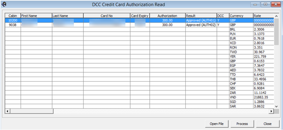

  4. You will receive a batch with currency exchange rate provided by the merchant. See the figure below for sample.
    Figure 6-17 Sample Response File with Currency Exchange Rate
    This figure shows the Sample Response File with Currency Exchange Rate
  5. Click the Process button to continue and this populates the authorization transactions onto the grid.
    Figure 6-18 DCC Credit Card Authorization Read Screen with Data
    This figure shows the DCC Credit Card Authorization Read Screen with Data
  6. Click the Process button again to begin the process. The progress status appears on DCC Credit Card Authorization Read screen.
  7. After the authorization completes, the authorization status in Guest Handling, Credit Card tab, View Authorization is updated to Authorized, with the exchange rate provided in the response file. The exchange rate is also stored in the DCC table.
    Figure 6-19 OHC Management — Credit Card Tab
    This figure shows the OHC Management — Credit Card Tab
Generating an Incremental File
When the total posting amount is more than the initial authorization, an incremental authorization is required. For example, additional posting is at $370 and the initial authorization is $300. The incremental authorization will be $70.
  1. At the DCC Credit Card Authorization Write screen, a converted (Onboard Authorization * Currency Exchange Rate) pending authorization transaction is listed. Click the Process button to write the authorization transactions into the file.
    Figure 6-20 DCC Credit Card Authorization Write
    This figure shows the DCC Credit Card Authorization Write

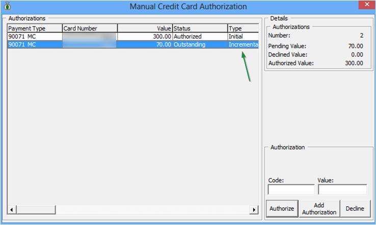

  2. In the Guest Handling, Credit Card, View Authorization screen, the status of the unconverted incremental authorization amount is listed as Outstanding status.
  3. To change the status to Authorize, see Reading an Authorization.
    Figure 6-21 View Authorization with Incremental Authorization — Pending Approval

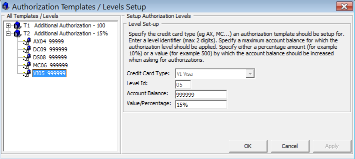

  3. Configure the Authorization template in percentage. For example, see Figure 6–23 — Sample Level Criteria Setup in Percentage.
    • Define the credit card type (VI Visa)
    • Define the Level ID ( 05)
    • Define the Account Balance (999999)
    • Define the Value/Percentage (15%)

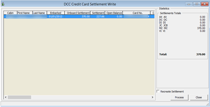

  2. At the Settlement Menu, DCC New Settlement screen, the settlement transaction is flagged with DCC, and the amount shown is converted using the exchange rate from the DCC table. (Onboard Settlement * Currency Exchange Rate).
    Figure 6-27 DCC Credit Card Settlement Write Screen (With Settlement Transaction)
    This figure shows the DCC Credit Card Settlement Write Screen (With Settlement Transaction)
  3. Click the Process button to write the settlement transaction into the settlement file.

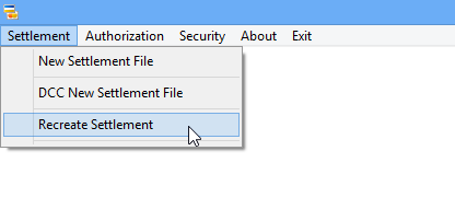

  1. Click the Recreate Settlement from the Settlement menu.
    Figure 6-28 Settlement Menu — Recreate Settlement
    This figure shows the Settlement Menu — Recreate Settlement

Table 6-6 OHC Tools Known Issue and Solution
Known Issue Solution
Error - ‘Key unable to upload’
Register PGPBBox7.dll with regsvr32.exe again.
Error - ‘License Key has not been set’
