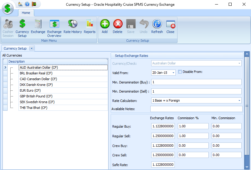

Adding Currency Code and Exchange Rates
- Log in to the Currency Module.
- At the Home tab, click Currency Setup and then click Add to setup a new Currency.
- At the Setup Exchange Rates section, select the currency type from the Currency/Check drop-down list.
- At the Valid From field, select the Validity Period for the exchange rates to take effect. Checking the Disable From check box prompts for a date to end the validity period.
- The default denomination for banknote and coin is one. Change the value if necessary.
- The Rate Calculation is divided
into two categories:
- 1 Base = x Foreign (Default)
- 1 Foreign = x Base
- Enter the exchange value of that currency. The Exchange
Rate is definable by its Operation Types:
- Regular Buy: Rate used by the ship to buy foreign currency from their guest.
- Regular Sell: Rate used by the ship to sell foreign currency (other than the base currency) to the guest.
- Crew Buy: Rate used by the ship to buy foreign currency from its crew members.
- Crew Sell: Rate used by the ship to sell foreign currency to crew members.
- Safe Rate: Rate used by the Vendor setup.
- Enter the value in either one of the commission field or bth. The Commission charged is based on the value defined. If both the Commission percentage and Min. Commission have a value, the system will post the higher calculated value for that transaction. The Min. Commission applies when the calculated commission by the percentage is less than the value specified in the commission amount.
- Click Save at the ribbon bar to save the changes.
Editing Currency Exchange Rate
- At the Currency Setup screen, select the currency type.
- Enter the Exchange Rates in the Exchange Rates section and click Save to update the rate. Once saved, you cannot undo the change.

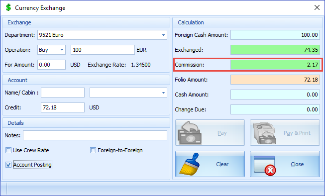

To exchange €100 to USD that has applicable commission at 3 percent. The calculation formula is (€100/1.345) = $74.35. Hence the applied commission is $2.17 ((€100/1.345)/3%)).
Figure 1-2 Commission by %

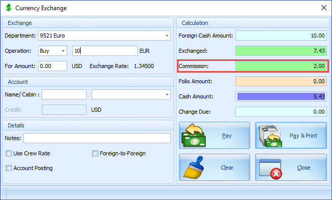

To exchange €10 and minimum commission is $2.00, the calculation formula is (€10/1.345) – $7.43 x 3% = $0.0223. Since the calculated value is below the amount specified, the system will post $2.00 as the applicable commission. Hence, the guest only receives $5.43.
Figure 1-3 Minimum Commission Charged
