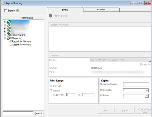

The X and Z reports are generated from Administration, Reports, Reports module.

Figure 5-1 Report Printing Function
This figure shows the Report Printing Function in SPMS.
