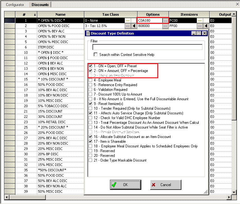

Log in to the MICROS EMC module and go to the Configurator menu.
Select Discounts from the System Information section.
Select a discount record that you want a POS discount to apply automatically on a guest check.
Under the Option column, click the horizontal ellipsis (...) button to open the Discount Type Definition window.
Select each check box as needed.
Figure 1-1 MICROS EMC Discount Record Setup
1 — ON = Open OFF (Selected)
2 — ON = Amount OFF (Selected)
3 — This is an Item Discount (Deselect)
Click OK to save.

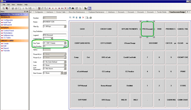

From the Touchscreens and Keyboard section, select a Workstations Design.
Double-click the Payment SCN to open the Touchscreen Design window.
Enter a new POS Discount key on the Payment window and enter all of the required details.
Set the Key Type to 21 — SIM Inquiry and enter the respective inquiry type using the following INQ numbers:
INQ 22: Loyalty Discount — Net Off Manual Discount (Discount by itemizer)
INQ 23: Advance Loyalty Discount — Net Off Manual Discount
INQ 24: Loyalty Discount (Discount by itemizer)
INQ 25: Advance Loyalty Discount
You can create four discount keys and assign them to a different discount handling.
Click OK to save.

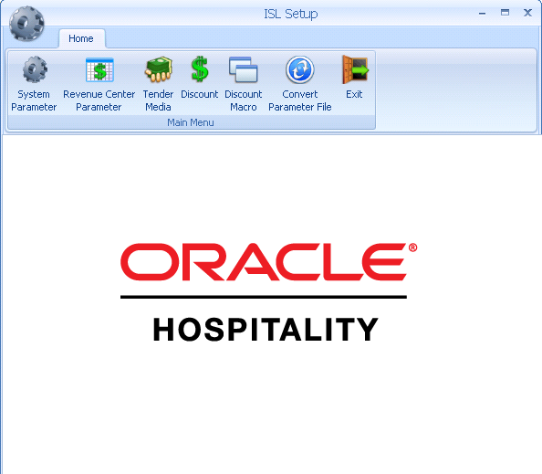

Log in to the MICROS server
Go to the
\\Micros\LES\POS\9700\etcfolder.Figure 1-3 SPMS ISL Setup Window
Run ISLSetup.exe.

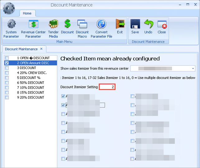

Click the Discount icon on the ribbon bar to open the Discount Maintenance window.
Select a discount record that has the POS Discount set up in the Administration module, POS Discount Rate/POS Discount Rate (Advance) setup.
Enter the Discount Itemizer number of the Revenue Center sub-department code (debit) in the Discount Itemizer Settings field.
Figure 1-4 ISL Discount Itemizer Setting
Select the applicable Itemizer checkebox and click Save.
