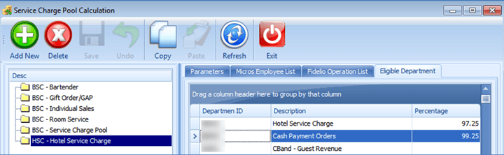

  1. At Service Charge Pool Calculation, create the new debit department for CPO posting.
  2. Define the percentage to distribute in Pool Calculation, Eligible Department setup under the same Pool Distribution type.
Figure 5-1 Service Charge Pool Calculation
This figure shows the Service Charge Pool Calculation window.
In the following example, the Cash Payment Order department = 99.25%. Amount collected only calculates the provision fees of 0.75%. The exempted credit card fees of 2% (100% - 0.25%).
Here are the scenario:
  • Amount collected from Hotel Service Charge department = $20798.66 (posting $21386.8 x 97.25%).
  • Amount collected from CPO department = $526.03 (posting $530 x 99.25%).
  • Total Amount collected for pool distribution = $21324.69.
