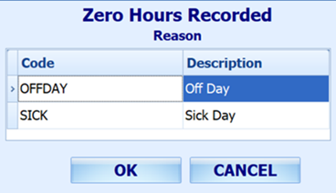

Approving Zero Hours
Figure 6-4 Zero Hours Reason
Once the Approve button is pressed and zero worked hours is detected, the system prompts an input screen for you to enter a reason.
Select the reason and then press the OK button to confirm.

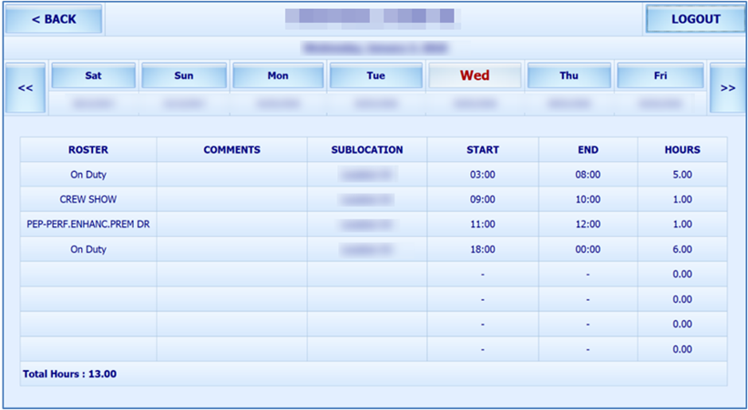

View My Schedule
Figure 6-5 View My Schedule Window
Pressing the day displays the respective daily schedule.
Pressing the double left arrow shows the past two week’s schedule and double right arrow to view the next two week’s schedule.

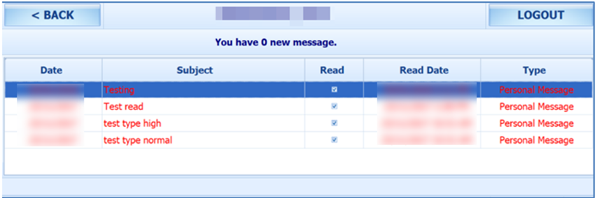

View My Messages
The View My Messages displays all the crew’s messages, sorted by date in descending order. The number of days to display is set in the Time Attendance, Display Messages x days old at terminal parameter.
If the value is set to 14 days, all read/unread messages that are 14 days old are shown.
Figure 6-6 View My Message Window
To view the message details, select the message from the message list
To delete the message, press the Delete button from the message dialog box
To exit the Detail Message screen, press the Close button. Read messages are shown on the message grid and viewable unless they are outside the number of days defined

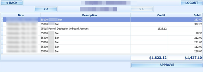

Approve Onboard Charges
It is compulsory for crew that opt to settle their invoices through payroll deduction set in the Payroll module, Crew, Edit Details, Contract Type/Pay Group/Pay Position to approve any onboard charges.
Payroll companies have “Deduct Folio” and “Invoice Payment Receiving” enabled.
Settlement department setup is similar to Payroll Companies – Onboard Account Department.
Crew payroll contract has “Deduct Folio” enabled.
The system sends a message informing the crew of the onboard charges that requires an approval and enables the Approve button in the View My Account screen.
Figure 6-7 Approve Onboard Charges Window
From the View My Account screen, select a transaction to approve. Multiple selection is not allowed.
Press the Approve button. Once approved, the Approve button changes to Already Approved.
If there are new settlements in the crew invoice, another approval is required.

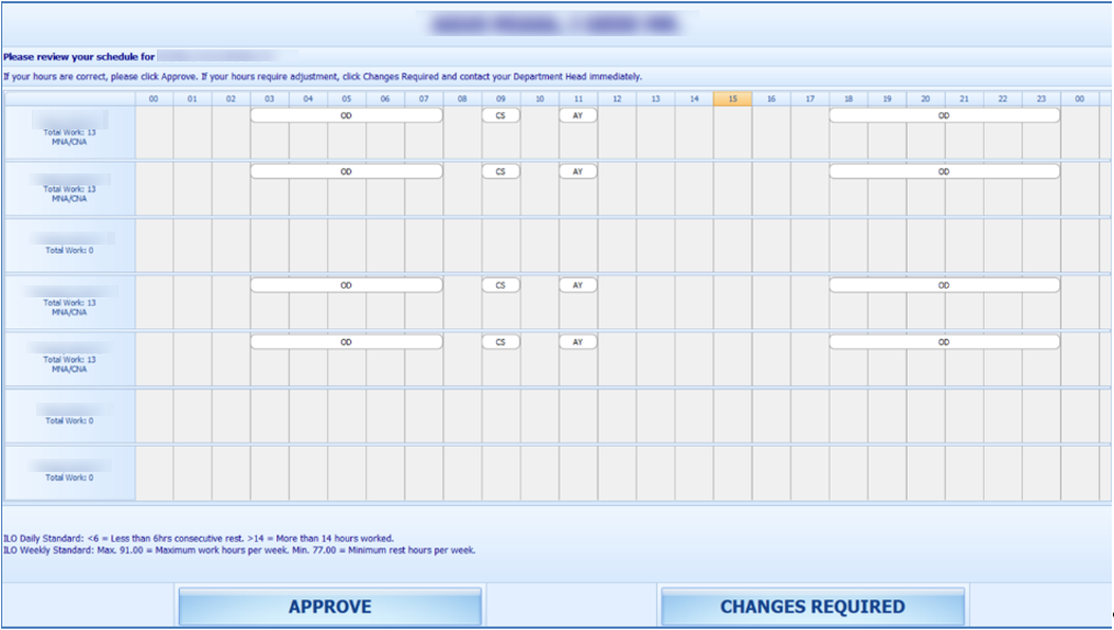

Approve My Weekly Hours
Approve My Weekly Hours enables you to approve the roster on a weekly basis. The function requires the following parameters: Time Attendance, Approve Weekly Hours set to 1, Time Attendance, and Approval Frequency set to the same day as the server day. The Approve My Weekly Hours screen pops up when you log in to the terminal, if there are unapproved weekly hours.
Figure 6-8 Approve My Weekly Hours
Total Work: The total hours worked.
Total Rest: The total rest hour block one.
MNA: Schedule not yet approved by manager.
CNA: Schedule not yet approve by crew.
CHG: Changes in schedules.
When the Approve My Weekly Hours is pressed, the system always shows the last week’s schedule.
Approve: Approves the week’s schedules.
Changes Required: Trigger a change request notification to the Department Head for the week scheduled to be changed.

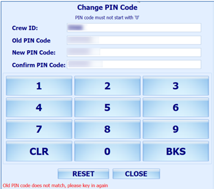

Changing PIN Code
The Change Pin Code function changes your log in PIN for the T&A Terminal access.
Figure 6-9 Change PIN Code
Press the Change PIN from the menu option.
Enter the required information. Use the following keys to navigate.
CLR: Clears the field input value.
BKS: For backspace.
RESET: Changes the PIN code.
CLOSE: Cancels the PIN code change.
The system prompts a PIN code change successful or a warning if,
The PIN code length does not match the value set in the General, PIN Code Length parameter.
Old PIN code entered is incorrect.
Missing information on the required fields.

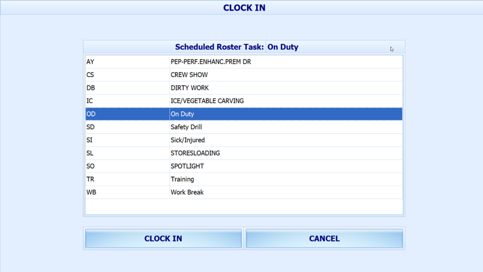

Clock-In
Clock In and Clock Out records the assigned task and the work hours so that the employee does not violate the total hours defined by the International Labour Organization (ILO).
Press the Clock In button from the Main Menu to clock in.
The Clock In option is disabled if you have not clocked-out from previous task.
If the PAR Use Clock In/Out option is enabled, the Clock Out and Change Task options will be disabled.
The system checks the clocked in time against the grace period defined in the Grace Period After Clock In parameter. If the Clock In time is within the grace period, the system defaults to the Scheduled Roster Task. Otherwise, it defaults to the top roster task on the list. For example, the grace period is 15 minutes and the scheduled roster is at 12:00, and crew clocks in at 12:07. The system defaults the Scheduled Roster Task as On Duty.
Select the Schedule Roster Task and press Clock In. The clock in task and time appears on the window.
Figure 6-10 Schedule Roster Task

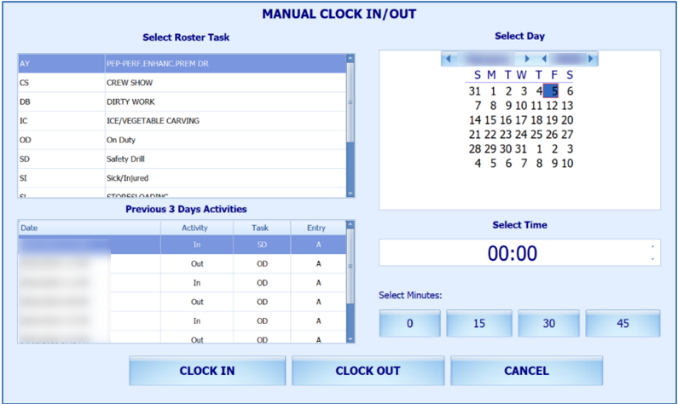

Manual Clock-In/Out
Manual Clock In/Out allows you to manually clock in/out of the system.
At the Main Menu option, press the Manual Clock In/Out.
Select the Roster task, day, and time.
Press Clock In or Clock Out to manually add the record. The past three days’ activities appear on screen.
Figure 6-11 Manual Clock-In/Out
