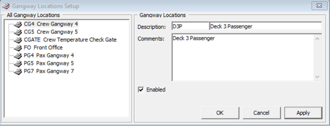

Gangway Location
Figure 1-1 Gangway Location Setup
Log in to the Administration module and select Safety Setup, Gangway Locations from the menu.
On the All Gangway Locations pane, right-click and select Add New.
At the Description field, enter the gangway location code and name, and additional comments about the location if any.
The new code is enabled by default. To disable, deselect the Enabled check box.
Click Apply to save the new record.
