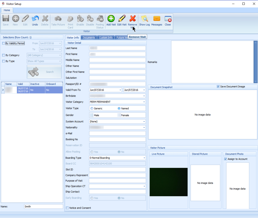

Adding Future Visits
Future visits can be added to visitors who visit the ship regularly.
At the Visitor Setup window, search the visitor record using the filters or enter the last name in the name search field.
Click Edit at the ribbon bar.
Navigate to the Future Visits tab and at the ribbon bar, click Add Visit.
Select the visit date from the calendar and click OK to add.
To edit, click the Edit Visit and select a new date.
To remove, select the visit date from the grid and then click Remove Visit.
