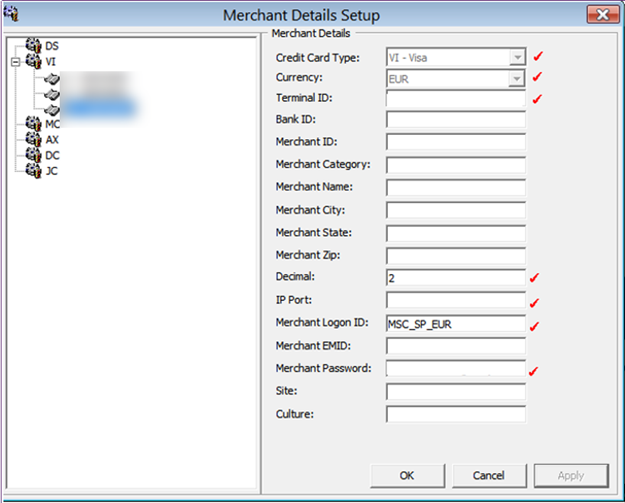

Merchant Setup
A merchant credential is required for credit card authorizations and payments to be handled efficiently. Prior to setting up the Merchant’s credentials, the following information must be ready:
  • Pre-configured Credit Card type
  • Currency code exist in currency table
  • Merchant information from service provider
Merchant Credentials
  1. Log in to the Administration module and select Financial Setup, Credit Card Merchant Setup from the drop-down list.
  2. Right-click and select Add New to open a new screen.
    Figure 3-1 Merchant Setup
    This figure shows the Merchant Setup
  3. Fill in the following fields correctly:
    1. Credit Card type
    2. Currency
    3. Terminal IF
    4. Decimal
    5. IP port
    6. Merchant Logon ID
    7. Merchant Password
  4. Click OK to save.
  5. Repeat steps 1 to 5 for other credit card types accepted by the Merchant.

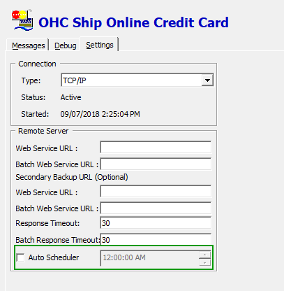

Setting up OHC Ship Transfer
  1. Start OHC Ship Transf.exe and navigate to Settings tab.
  2. Under the Remote Server section, insert the following URLs obtained from the respective payment gateway provider in the respective field:
    • Payment gateway URL / Web service URL
    • Batch Payment gateway URL / Batch Web service URL
  3. To set an Auto Scheduler for batch authorizations to be sent daily at a scheduled time, select the Auto Scheduler and set the desire time.
    Figure 3-2 OHC Ship Transfer Scheduler
    This figure shows the OHC Ship Transfer Scheduler
  4. This function is only applicable to the Ingenico Online Credit Card format batch authorization. For Batch Settlement, these are performed in Management/Crew, Credit Card Batch Settlement function.
  5. The above settings are saved in OHCSettings.Par under the following tag:
    Table 3-5 OHCSettings.Par
    Field Name Description
    [#ShipTransf.Connection.AutoScheduler=1#]
    Indicates whether the Auto Scheduler is turn on/off (1 = on, 0 = Off).
    [#ShipTransf.Connection.AutoScheduler Time=23:30#]
    Indicates the time set in Auto Scheduler.
    [#ShipTransf.Connection.last Date Auto Authorization=20150307000000#]
    Indicates the last sent date/time of the batch top up. The saved date/time format is YYYMMDDHHMMSS

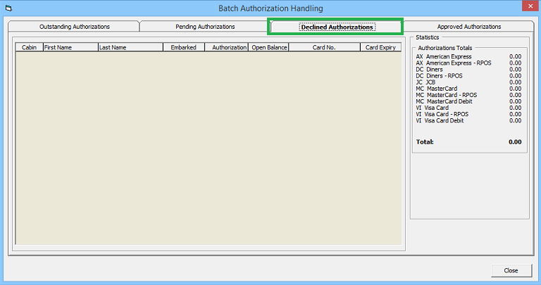

Generating Batch Authorization
The Credit Card Batch Authorization function sends authorization requests of credit/debit cards marked with ‘Online top up amount’ by batch to Ingenico through the Ship Transfer interface.
  1. Log in to the Management module.
  2. Select Credit Card Batch Authorization from the menu-item to open the Batch Authorization Handling screen. The Batch Authorization Handling screen includes four tabs.
    Table 3-6 Batch Authorization Screen
    Tab Name Description
    Outstanding Authorizations
    Authorizations request yet to be process.
    Pending Authorizations
    Authorizations request pending approval from service provider.
    Declined Authorizations
    Authorizations request declined by service provider.
    Approved Authorizations
    Authorization request approved by service provider.
  3. To process the batch, select the desire tab and click Process. A progress bar is shown on the screen indicating the batch progress.

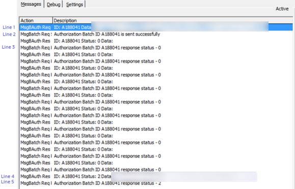

  4. Information is passed to the OHC Ship Transfer to request authorization from Ingenico. The status of the batch authorization is reflected in the OHC Ship Transfer Message tab in the following example:
Figure 3-7 OHC Ship Transfer Messages
This figure shows the OHC Ship Transfer Messages
Table 3-7 OHC Ship Transfer Message Description
Message Line Authorization Status
Line 1
Batch authorization requested to service provider.
Line 2
Batch authorization request is successful, can start sending batch authorization data.
Line 3
Batch authorization data sent successfully to service provider.
Line 4
Batch authorization data send completed, and now awaiting response from service provider.
Line 5
Batch authorization response from service provider.

Line B
Batch Settlement sent successfully.
Line C
Await response from service provider.
Line D
Response from service provider (Positive /Negative/Refund amount).
Line E
Response updates statuses.
0 - Not Processed; 1 - Processing; 2 - Processed; 3 - Error.

MsgErr <HT> Logon ID is Missing
Register the Wrapper.dll with regasm.exe
Ensure the Logon and Password is configured in the merchant setup.
