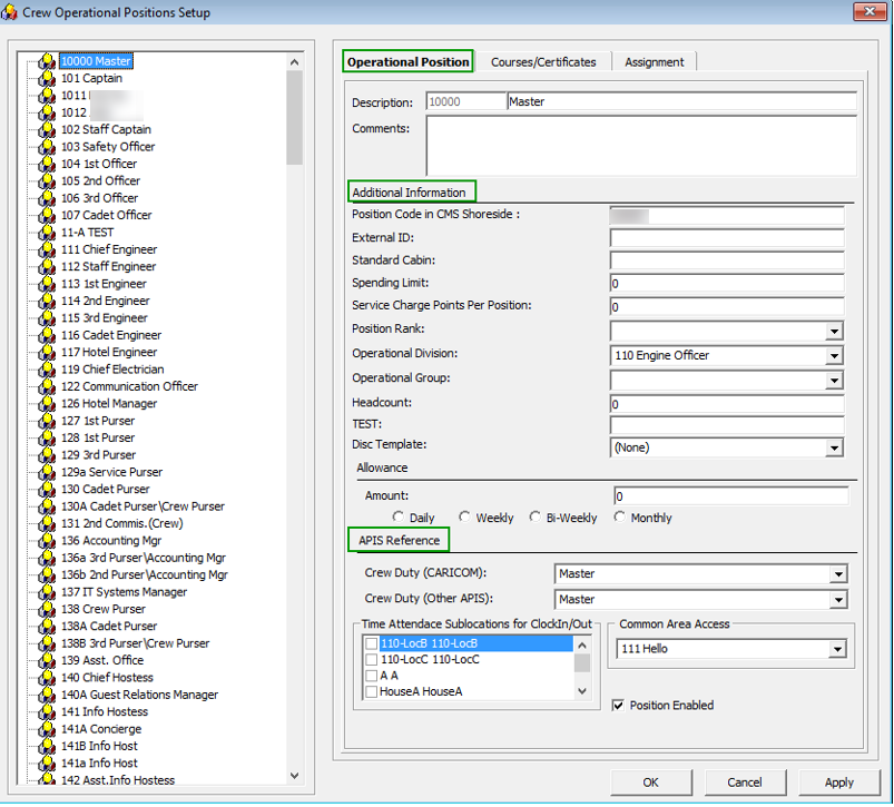

Operational Position Setup
An Operational Position is required in the Advanced Passenger Information System (APIS) as references and for reporting, and this is set up in the Administration module.
Figure 1-1 Crew Operational Position Setup
This figure shows the Crew Operational Position Setup.
  1. Log in to Administration module and select Crew Setup, Operational Position from the drop-down list.
  2. Right-click and select Add to create a new Operational Position or select from the existing list.
  3. Navigate to the Operational Position tab and enter the Position code, description and comment.
  4. Under the Additional Information section, select the Operational Division from the drop-down list.
  5. Under the APIS Reference section,
    1. Define the Crew Duty (CARICOM) position
    2. Define the Crew Duty (Other APIS) position
  6. Click OK to save.

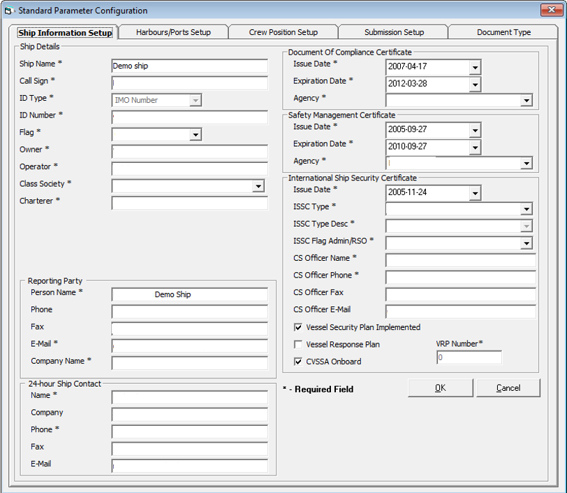

Ship Information Setup
To generate a report, you must first setup the Ship information in the EBorder UK application.
Figure 1-3 Standard Parameter Configuration Window
This figure shows the Standard Parameter Configuration window for EBorder UK.
  1. Run the EBORDER UK.exe.
  2. Select EBORDER UK Setup from the EBORDER UK Transfer.
  3. At the Ship Information Setup tab, enter the ship’s information.
  4. Click OK to save.

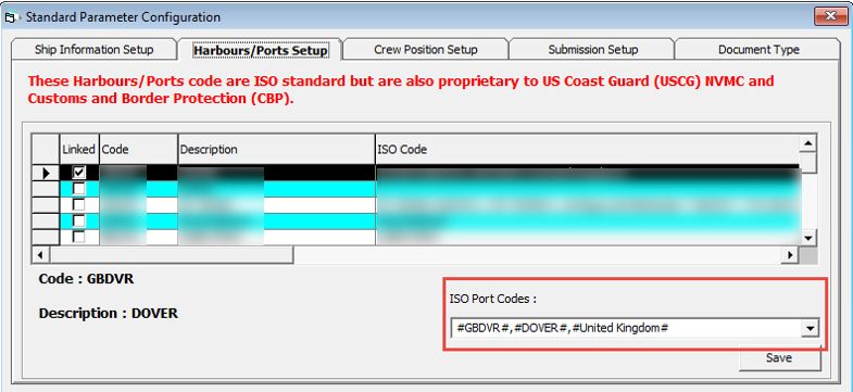

Port Setup
The Port Setup is differentiated by the symbols used and stored in the XML files. For example, the ISO Port Code for Dover has a hashtag (#) and angle bracket (<) symbols. This means the ISO Port is shown in the Standard Parameter Configuration, Harbours/Ports Setup, ISO Port Codes and eNOAD Port. See the following table and figures for symbol use in the port setup.
Figure 1-4 Harbours/Ports Setup
This figure shows the Harbour/Ports Setup window and the ISO Port Codes with corresponding symbols used.
Table 1-2 APIS Port Type and Symbols
Port Type Symbol
CARICOM Port
eNOAD Port
Panama Canal ADR Port
eBorder UK Port
