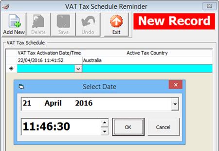

VAT Tax Reminder
Figure 9-14 VAT Tax Reminder
- From the Financial Setup menu, select VAT Tax Reminder.
- Click Add New at the ribbon bar, and then select the Date and Time from the drop-down list.
- From Active Tax Country, select the Country in which the tax is to be activated.
- Click Save to save and exit.
