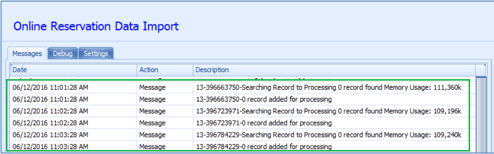

Refresh Interval
Figure 5–1 below shows the system constantly checks for new records to process every 60 seconds or per a defined interval time.
Figure 16-8 Sample Refresh Interval Messages
This figure shows the sample refresh interval messages logged by DGS.

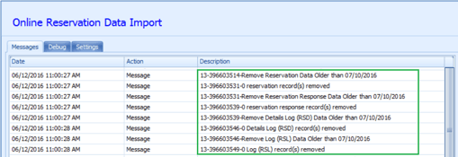

Delete reservation data older than 60 Days
In the Messages tab, data older than 60 days from the date of modification is removed.
Figure 16-9 Sample Deleted Reservation Message
This figure shows the sample messages of deleted reservation.

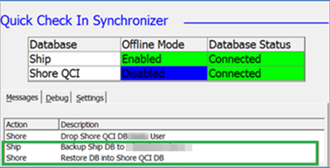

Stop process when QCI Offline Sync is enabled
This parameter backs up and restores the latest database to the QCI Shore Database when the parameter is enabled and the QCI Sync Interface is started.
At the point when Quick Check In Synchronizer Ship database mode is in an Enabled status in Offline Mode, the DGS ResOnline Interface status switches to a Pause and resumes when the Offline Mode is Disabled.
Figure 16-11 QCI Synchronization Status
This figure shows the QCI Synchronizer Status when when QCI Offline Sync is Enabled.

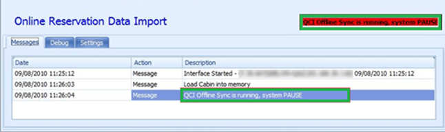

Figure 16-12 DGS Pause Mode
This figure shows the DGS Pause Mode when QCI Sync is running

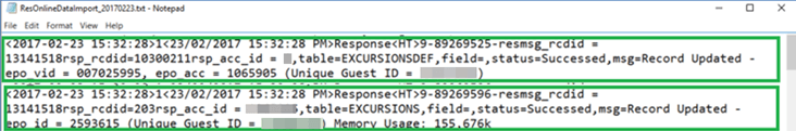

Do not allow Import Zero Price Shorex/Ticket Prepaid/Prebook Transactions
When this parameter is checked, the system checks for prepaid records that have an empty price in the XML file, and rejects the import and then sets status=Fail.
Figure 16-18 Sample messages Do Not Allow Import Zero Price From Shorex/Ticket Prepaid/Prebook Transactions
This figure shows the sample Do Not Allow Import of Zero Price Shore Excursion, Prepaid Ticket/Prebook Transactions that has empty price value.
