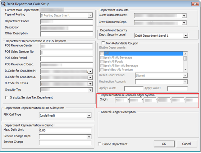

  6. Go to Administration, Financial Setup, Department Codes.
    Figure 27-1 Debit Department Code Setup
    This figure shows the GL Representation Code field in Department Setup.
  7. At the Setup Department Codes window, select the sub-department code and click Edit.
  8. At the Department Code Setup window, go to the Representation in General Ledger System section, enter the GL Code in the Origin field.
  9. Click OK to save.
