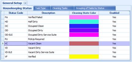

Figure 12-5 Housekeeping Status Setup
The figure shows the Housekeeping Status Setup window.

  1. In the Home tab, select General Setup and then select the Housekeeping Status tab.
  2. Select Add from the ribbon bar.
  3. In the New Housekeeping Status window, enter the code, comment, and select a color that represents the status from the color palette.
  4. The newly added code is enabled by default. Deselect the checkbox to disable the code.
  5. Click Save to save the status.
Editing Housekeeping Status
To change the status description or color, either double-click the record or click Edit on the ribbon bar to open the Edit Housekeeping Status window.
Disabling Housekeeping Status
To disable a status that you no longer need, select the status and click Delete. Deleting a default status is not allowed. This process only disables the status and does not remove it from the Housekeeping status grid.
